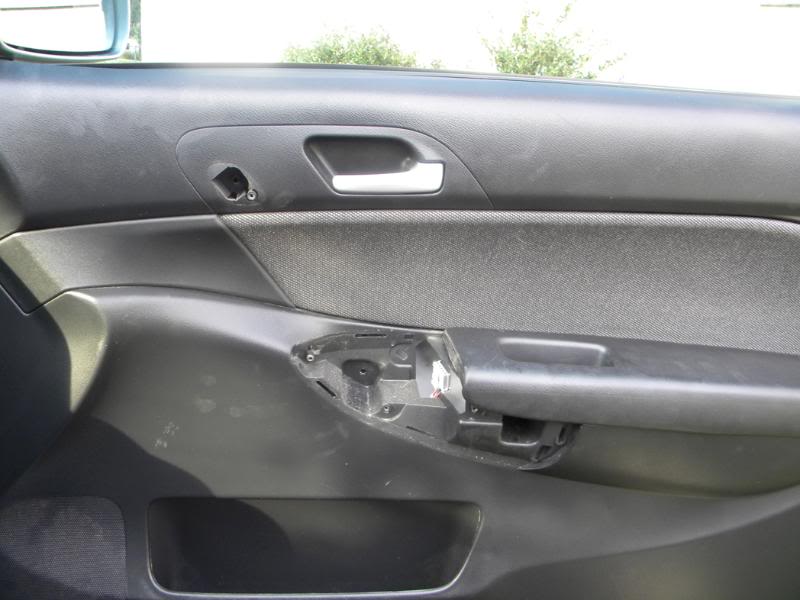

door pannel( sorry for the blurryness)
pry there to pop that piece off

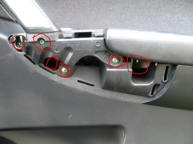

take out the 6 screws(4 small, 2 big)

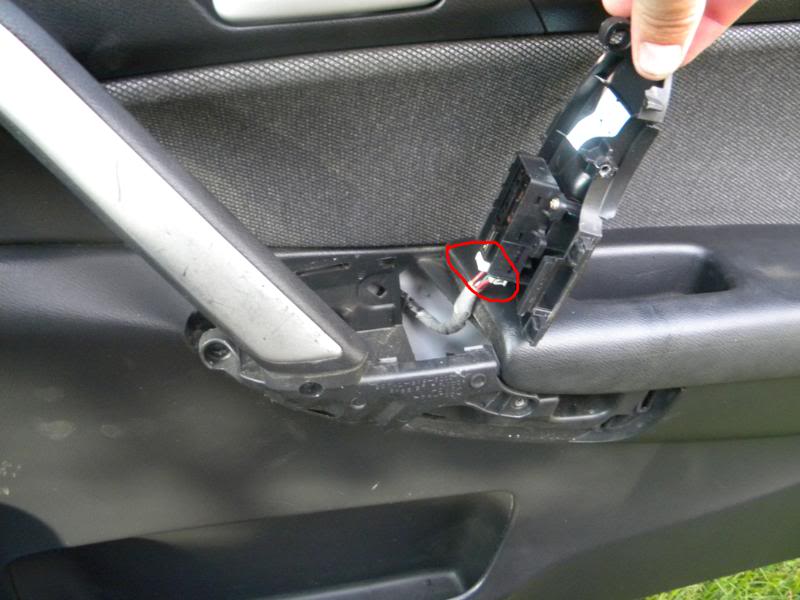

remove the harness from the window switch

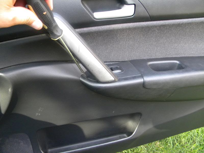

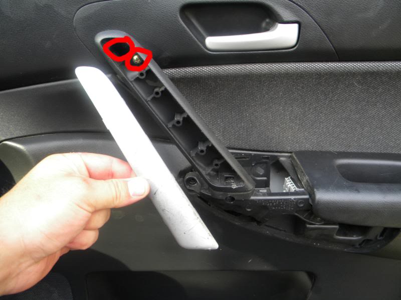

pry the silver piece out w/ screwdriver and remove the 2 screws

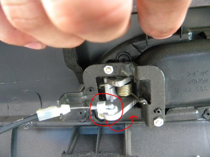

pry the blue piece off of the door latch thingy, be careful not to break it. and remove the cable

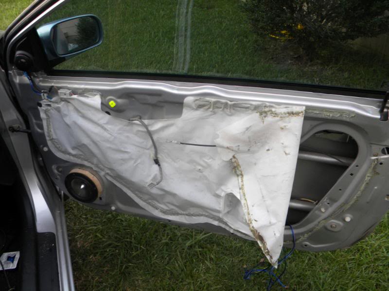

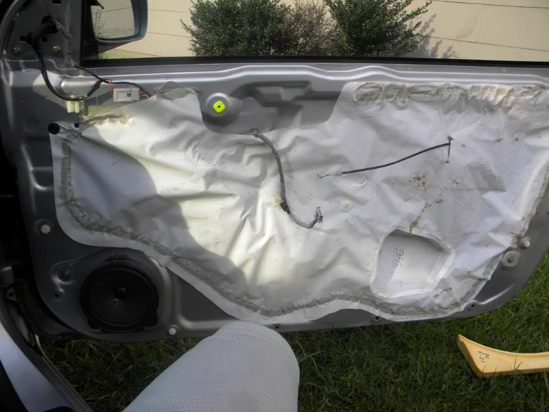

door pannel removed

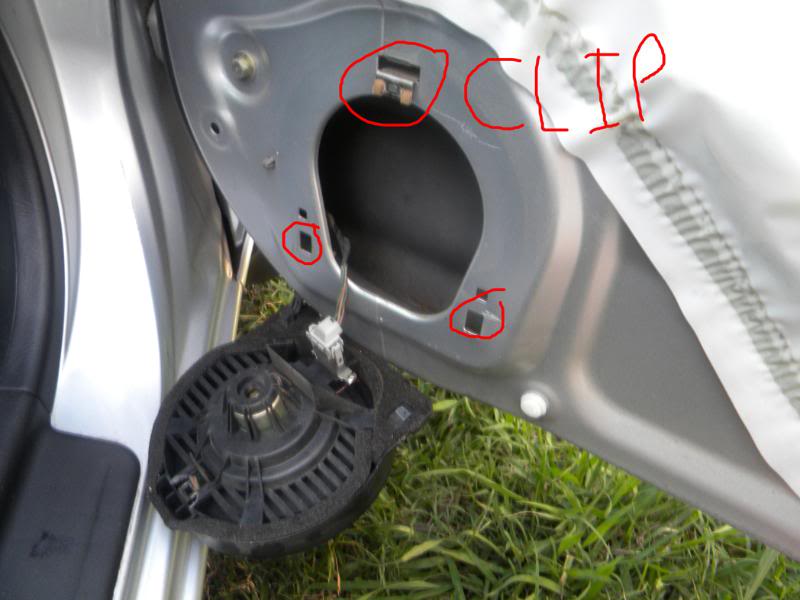

push down on the clip and then lift up. or you can do what i did and just pry it out with a screwdriver and break it cause i didnt know how to do it haha

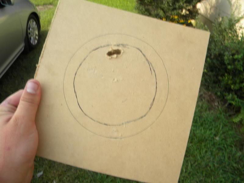

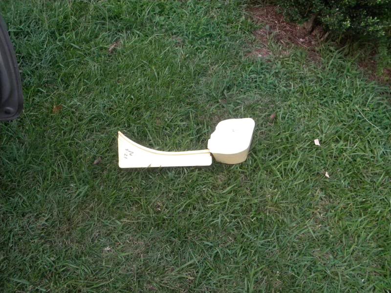

heres my speaker baffle, wouldnt recomend mounting speaker directly to the metal. it also doubles as a spacer

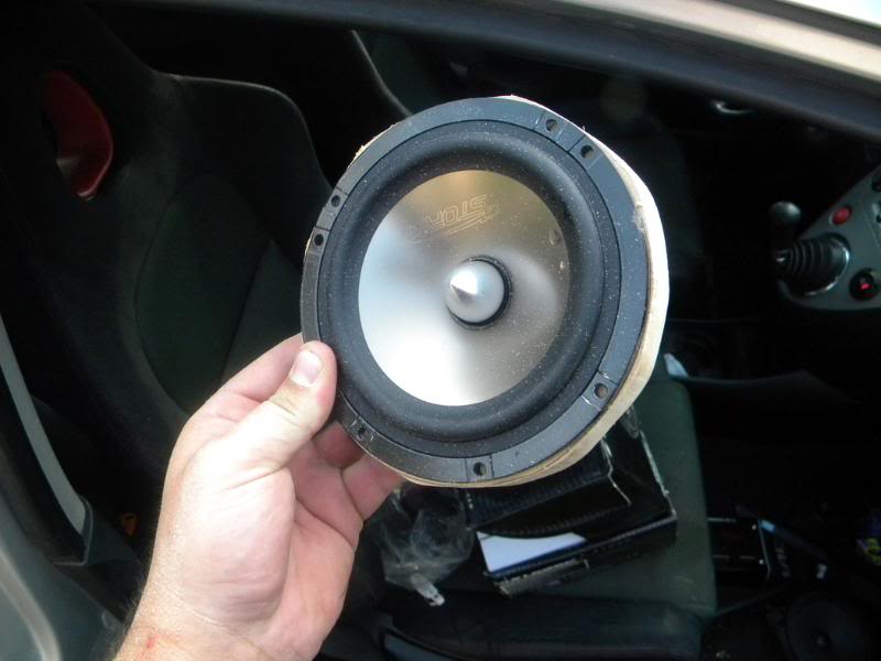

mock up on the speaker. easyiest way to mount:drill hole thru wood and metal ,about 3, then install screws countersink them a little bit so they dont stick out, then put your speaker in and screw it down

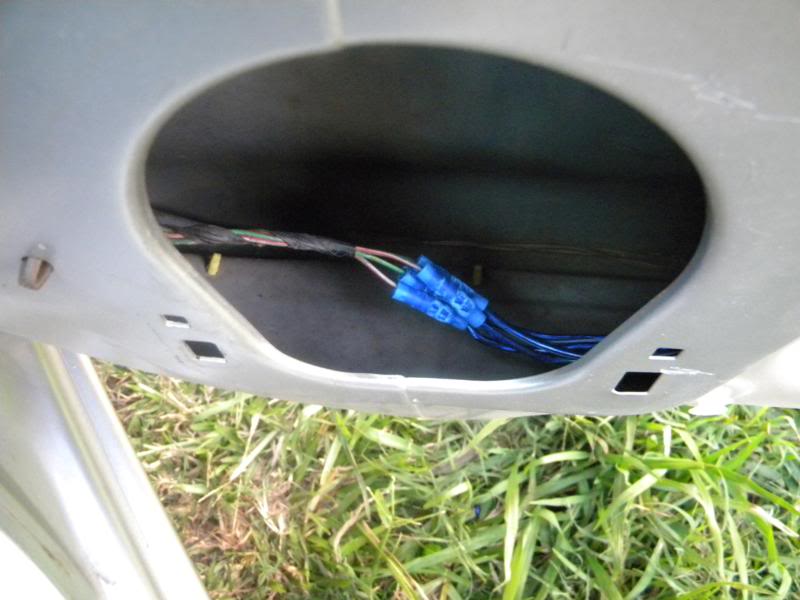

stock wires crimped with longer wire to go to the crossover(didnt relize at the time but you not going to need the green wires because those go to the tweeter and the tweeter will have a new wire to it

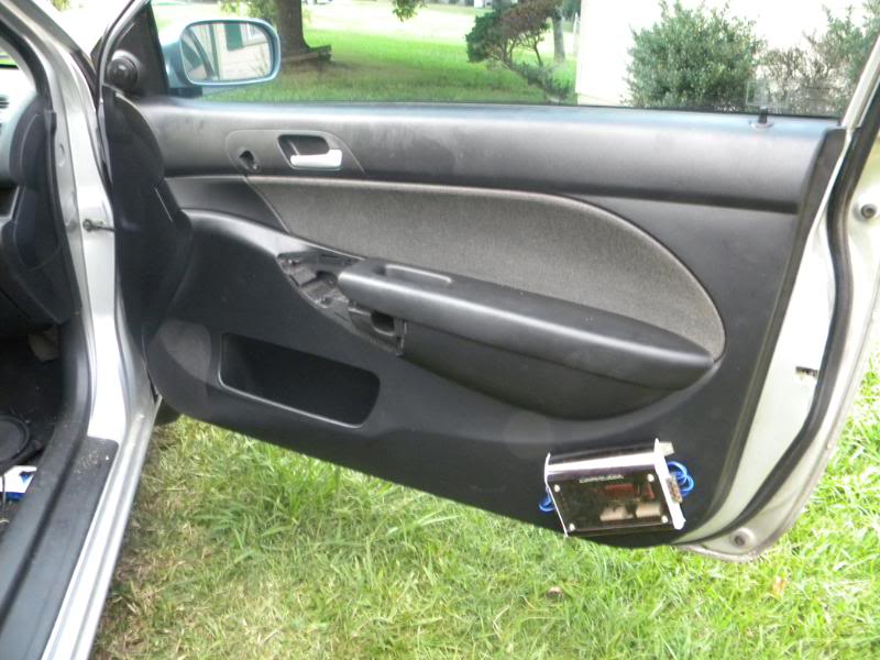

door pannel on and crossover installed, need to change the wires up a little bit
