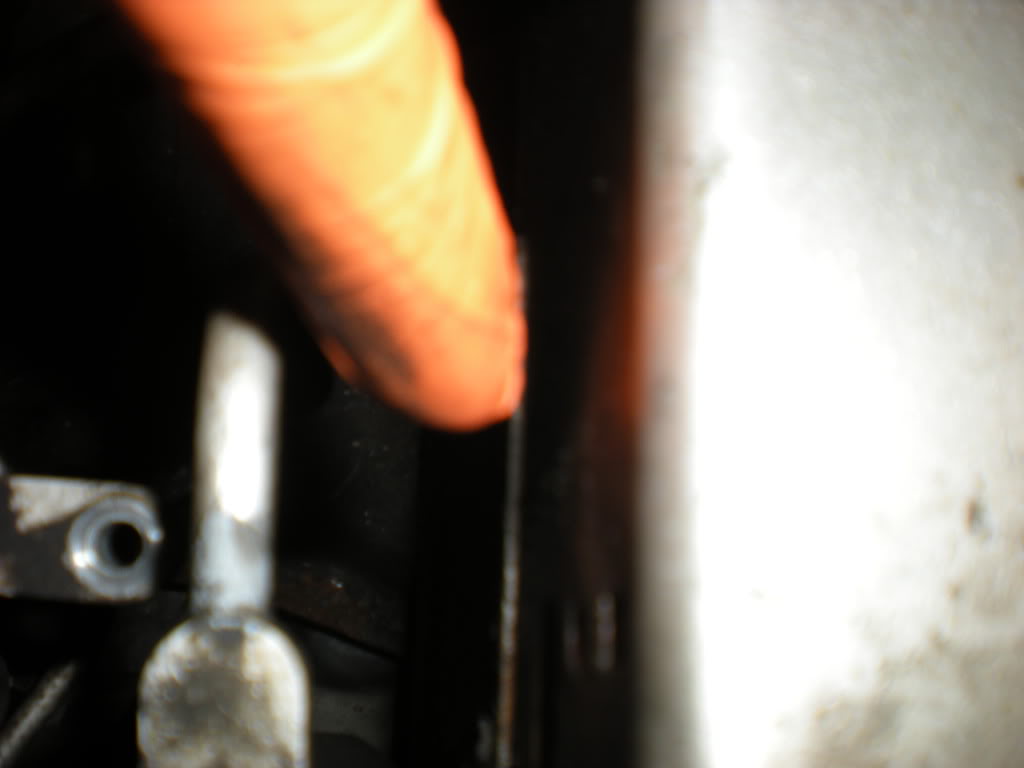

Then goto driver side headlight and remove these bolts.

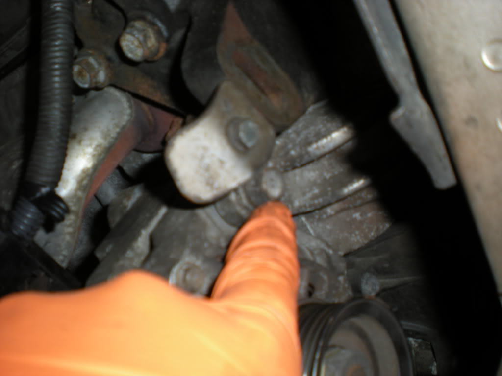

Untighten this bolt

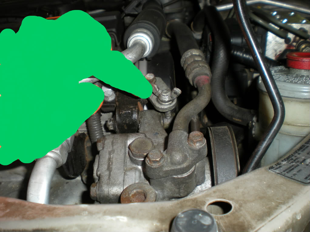

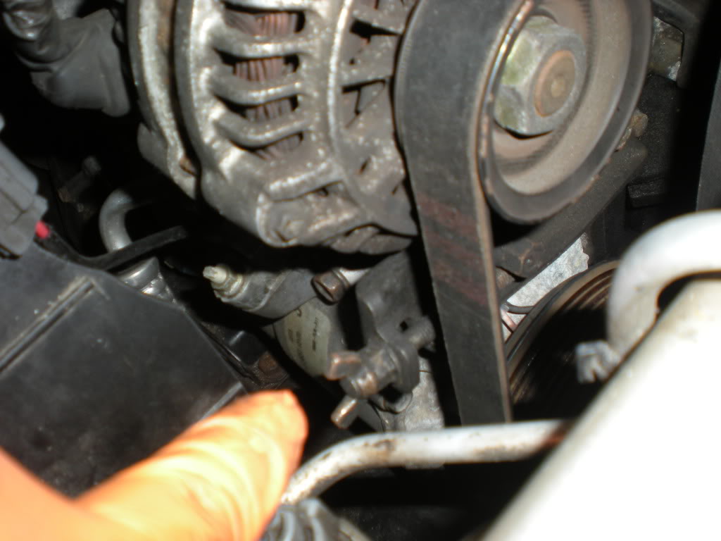

Then untighten this
Also undo this bolt
Once the belt is loose remove it

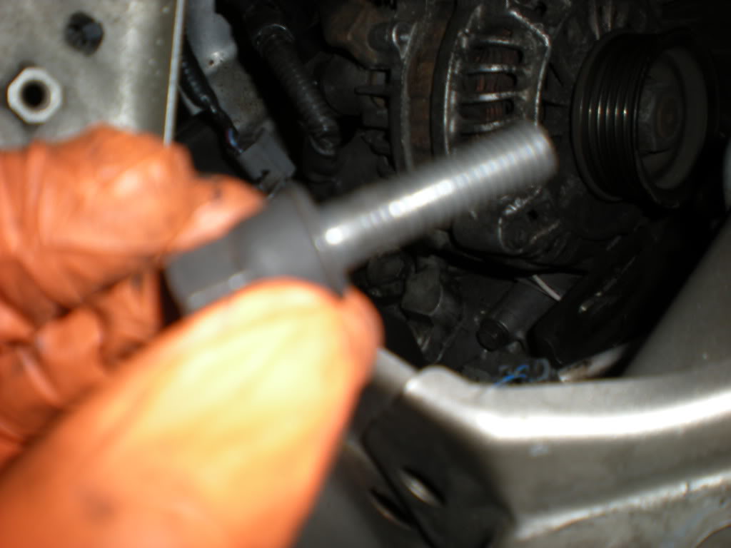

Then remove the bolt

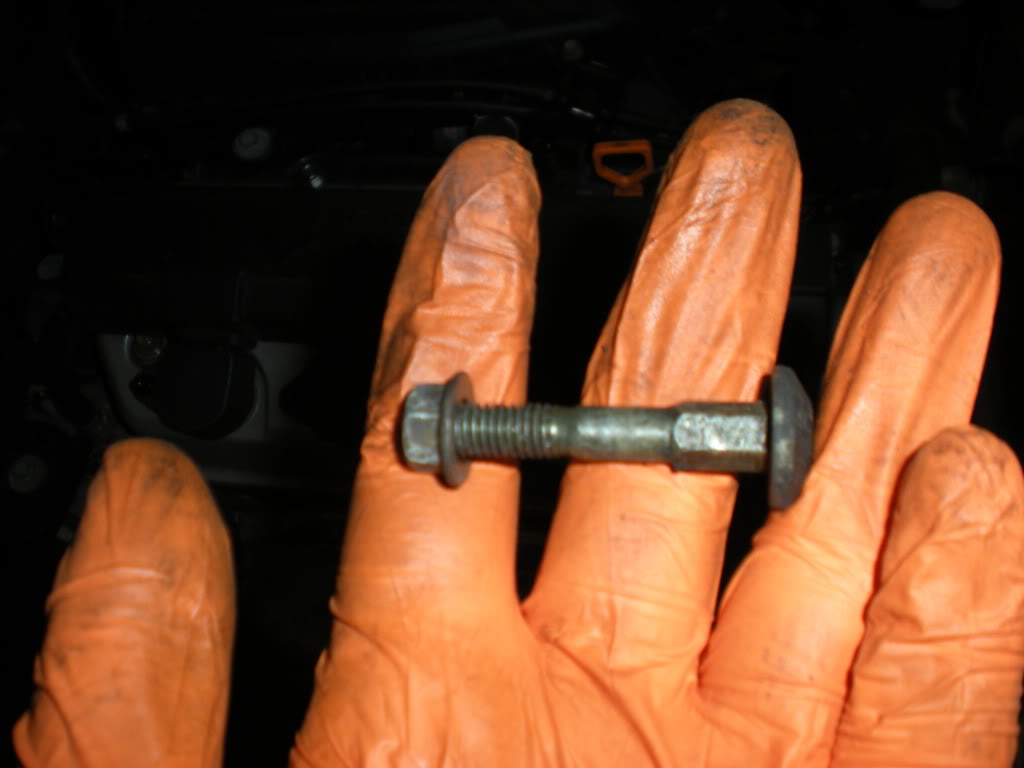

Remove this bolt as well

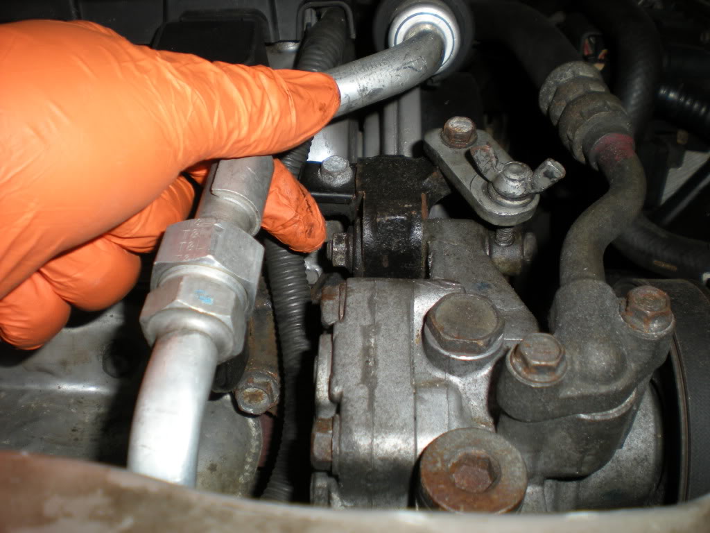

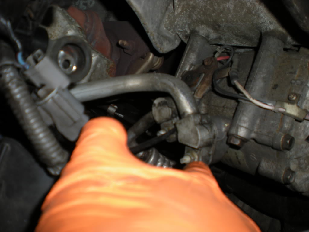

Remove the 2 lines
Put the line aside like this

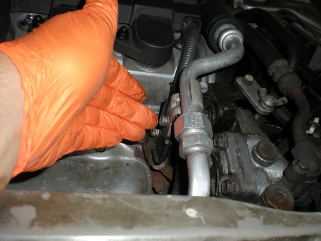

Then remove the 4 bolt hanging onto the Compressor
