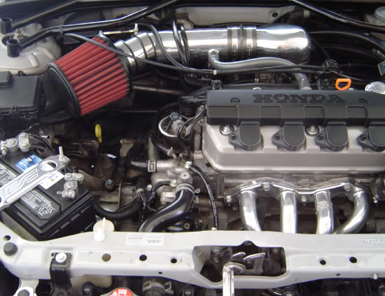

first pic shows the t-bracket mount on the elbow area with rubber grip, and the top of the bracket.
next pic shows a closeup (hard to see) where a long joint bends down to the cruise control bracket. i used a standard bolt with lock washer and nut from the bottom to hold the lower mount.
end result, a perfectly level and secure intake

I'm sorry for posting in a thread as old as dinosaur poo but I just installed my new Secret Weapon yesterday. It's quite the discreet monster, but the included mounting bracket is completely useless. Gearbox's mounting bracket fix worked for me, however since the engine bay in my manual '03 EX is a bit different (not to mention dirtier!), I had to mount it differently.
I've been living on these forums for the past month now and this is my way of paying it forward for some poor newbie like me. Thanks everyone!
Here's the Spectre mounting kit (part 8703) and the 3" bracket (part 8701). I paid about ten bucks for the whole thing at O'Reillys.
Here's where I had it mounted to the cruise control box. I used an existing bolt to keep it on. It was a bit of a pain to get it tight, but eventually I prevailed!
Here's a close-up of my bracket configuration.
Here's the whole thing! The bracket doesn't look too bad! There's a bit of wiggle room like Gearbox said, but it seems sturdy enough and it doesn't sag anymore!
