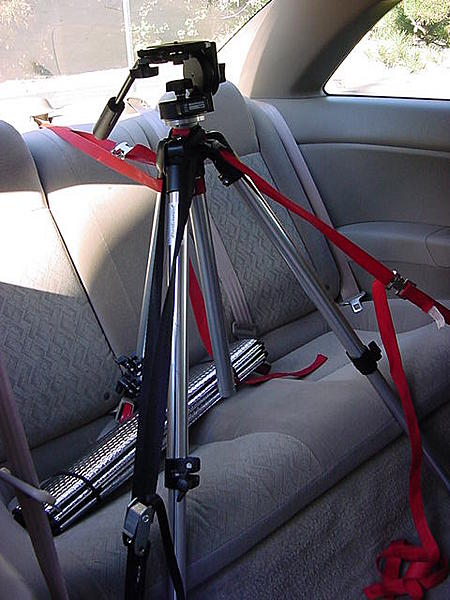

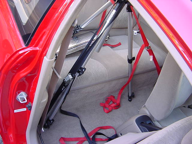

Basically what I wanted to do was add a camera in my car to show what it was like from an in car perspective. I took my tripod and adjusted it so the two front legs were extended out, and adjusted to the height of the floor. Man, your really going to have to take a look at the picture, cant explain this as well as the pic can. The third leg I pushed down into the seat belt hole on the rear passenger side until it touched the sheet metal under the cushion. This was basically good enough, the tripod leg was just a perfect fit in the seat belt hole that it didn’t move around during daily driving. But whatever, I wanted more insurance that it wouldn’t move around with some more aggressive driving. The point of the tie downs is so the camera does not become mobile in the cabin and cause damage to YOU- DO NOT PUT A CAMERA IN YOUR CAR IF IT IS NOT SECURE!!

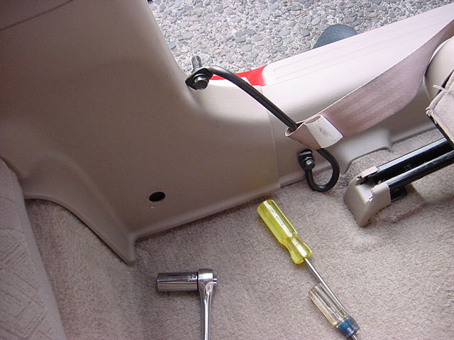

So, I have a coupe and we have some funky lower seat belt stays. I've attached a picture of a time when I had it halfway taken off to remove a panel (note- you do not need to unbolt these!!). I took some tie downs that you'd find in most automotive stores to tie stuff down to your roof racks or truck bed, the kind with the clamp. I strung two around the bottom seat belt stays and over the tripod head. These are like giant belts that pull the tripod to the left, and to the right. Then my only issue was it rocking forward and backward. So, you know those red child seat hooks on the rear deck? Yeah, time to use those puppies. I laced another tie down through one of those and around the tripod head to pull it back. I made some more adjustments to where the camera position would be-- so it would catch all the action, and not a whole lot of my roof, or a whole lot of my dash and floor. If I remember correctly, I slid my seat somewhat forward and then reclined it to get the seat out of the way, and also to hold it in there just a tad more---not like it needed it- because when I was standing outside and shook the tripod- the entire car shook- there was absolutely NO play. So it was in there and ready to go, although it was night time, damn.
The next morning I screwed my camera on, along with a WIDE-ANGLE lens, double checked everything again and stated up. (If your going to be driving a little aggressive I don’t think I should have to mention it- and if I do, you probably shouldn’t be driving aggressively in the first place—but make sure your engine is warm before you start pushing it so you don’t cause under-the-hood damage) So driving down the local roads in the city wasn’t anything new. But when I made it out to the open roads, man… pretty amazing. The camera didn’t move around at all. The angle caught the entire steering wheel to the right mirror, the whole windshield, stick shift and speedometer. Pretty ridiculous video footage when I was whipping around corners in the back road to see my hands just spinning the wheel around, and me shaking around in the car and everything speeding by while shifting gears. But seriously though, I'm not trying to paint the picture that I’m a speed daemon or a ridiculous ricer or whatever, but until you strap a camera down in your ride and take it out on the back roads for some fun, you have no idea how amazing it looks on camera.
