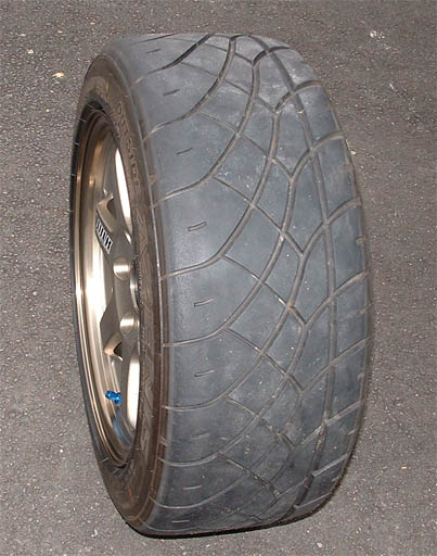

225/50/15 is one of the best tire sizes to run. Lots of choices in both R-comps and street tires.
Link
My buddy is planning on running 15x8's and 225/50's on his E30, ET 22. He's a wheel ***** though, he's got 3 sets of stockers, and two sets of 16's.

this is what he got:
