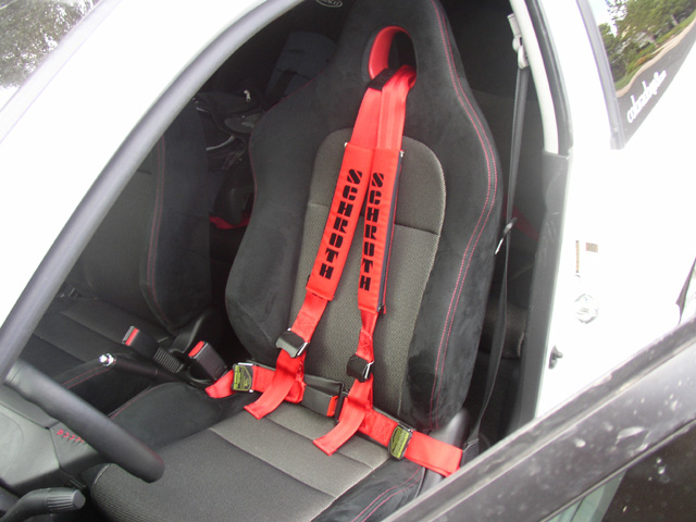

But honestly.....a good Schroth 4 point will work JUST FINE. (and it's legal)
This is mine...

Can't use a 5 or 6 point with a stock seat. You can't run the nutstrap up from the front, racing seats have a slot in the middle it needs to go through. You can use a 3 or 4 point with relative ease. Thats enough for autocross, all you really want to do is keep your shoulders and hips in the seat. I'm using an OMP on the drivers side and a Scroth on the passenger. No complaints about either.
