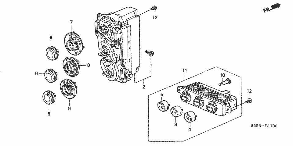

Heater control panel.....the unit next to the radio....
Those bulbs share the same fuse as the rest of the lights in the gauges/cruise/hazard/AC/defog/stock radio, so if those all work then it's not a fuse issue.
You took it apart and replaced the little bitty bulbs behind that panel?
Did you check if the bulbs were actually good before you installed them?
If you have a voltmeter you could check if each bulb mount is getting proper power and ground
Bulb is item #1, the parts catalog says there should be two of them in the unit:
i check everything and the heater control panel is all good , but i noticed the bulbs from the A/C buttons. both are blown
