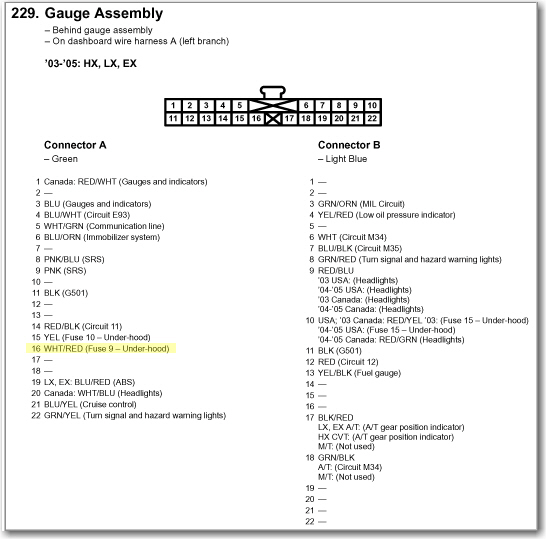

I own a 03 Honda civic ex coupe/ auto, with a 03 ex sedan manual cluster in it,i neglected to notice the first couple months, that i don't have reverse lights, and i hate myself for not understanding this before i put the cluster in, anything i can do to solve this correctly and get my reverse lights back without switching the clusters, i understand the gear sensor is the problem, how do i solve? any information would be appreciated, thanks
Old Mar 16, 2013
Re: I CANT SEE! Behind Me. . .
(I'm running with the first wire diagram I see here, so bear with me.)
I think you will have to jumper 2 wires at the gauge connector.
There are 2 possibilities I'm seeing here, since this diagram covers more than one version of the car.
B connector is the light blue one
White wire, terminal B6 (or B11)
needs jumped to
Green/Black wire terminal B18 (or B4).....another diagram shows this wire as white too, so be careful.
Another diagram shows it Should be B6 to B18. Wht to Grn/blk....Check.
This should reconnect the Trans Range Switch Reverse terminal to the A/T Reverse Relay, bypassing the gauge cluster.

good enough? after i confirm with my cluster ofcourse.

Looks like the same page I had.

then where is the confusion? should be a straight b6 to b18, with the exception of confusion from b17 i dont understand how it could be anything different.

ahh, understandable, regardless i appreciate your help, just dont understand what the circuit m34 is and trying to figure it out before i splice. unless its the Trans Range Switch Reverse Terminal and the A/T Reverse Relay as you stated before. but the gear position indicator has nothing to do with it?

Ignore the M34. It is only a name given to that particular circuit.
Like "M35" is the circuit that contains the "P"ark indicator light in the cluster.
