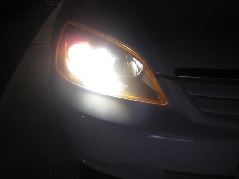

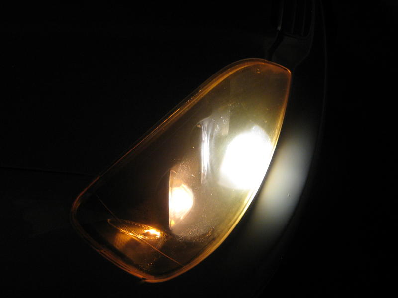

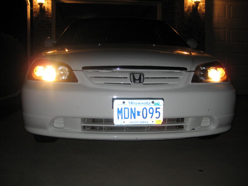

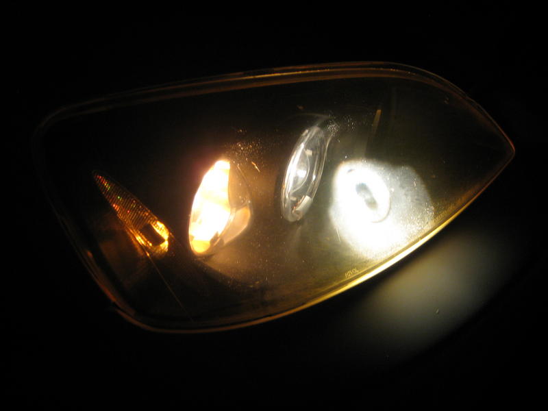

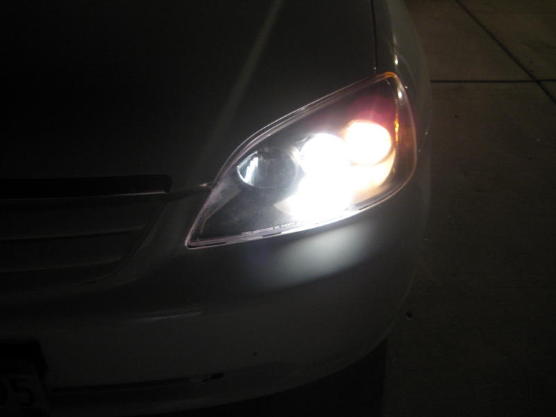

So I bought this civic just a few months ago. It's an '02 ex sedan. It is mostly stock with a few exterior exceptions. So, I have noticed that the passenger side headlamp unit is turning yellow. It's pretty nasty, and certainly makes my car look bad, especially at night. I'm curious if anybody has any ideas what would cause the headlamp to turn yellow, and how or if it can be prevented, if possible? Or any other words of wisdom that anyone would like to share.

Oxidation of the plastic lens. There's a Diy guide to restore your headlights around here.. Somewhere

Nah, it's fairly common. I've had to "fix" it on my aftermarket projectors, step-mom's MB E420, bout to do the same on my cousin's 02 focus, and seen it on many, many more cars.

Hazing of plastic lens happens to all cars that have plastic lens and aren't properly cared for.
(Properly cared for meaning, washed at least once a week, and kept in shade/garage)
I believe Meguiars has a whole headlight restoration kit now, though i think that goes for about 15~20 bucks
But plast-x should work just as well

use toothpast to clean the headlight plastic, it's better than spending money on restoration kit, I tried it
