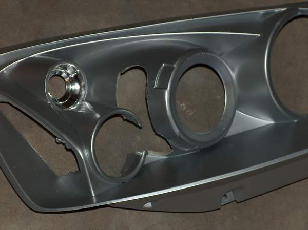

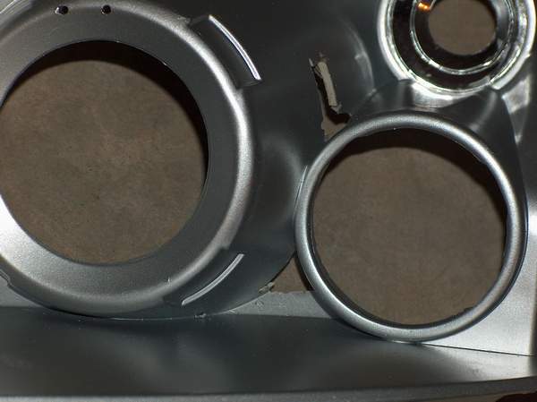

well, i've passed the point of no return. TSX it is!
the cost of trial and error:
after learning from the first one, this is all that needed to be cut:
i might try and buy a shroud off somebody rather than trying to repair the first one with bondo or something.

Potentially dumb question, but the TSX headlights (complete not just the HID assemblies) are one for one swap on the 7th gens with a bit of wiring work?

hmm hope you dont have to cut much to mount the tsx. for my sonars, i kept the original goo which must be heated in the oven to become soft. then when hot you press the two sides together. after that i put silicone all around the outside edges because there were some gaps in the stock sealant. the only drawback is if i ever want them apart again, i have to cut through the silicone cause it does not change when exposed to heat. so put silicone when you know they are done completely.

i've never heard that. they're not the same shape as the 01-03 i don't think.

oh, and that IS how much i already cut. those are my shrouds in the pic. i've already started repairs though. i glued most of the "chunks" back together and I'm going to repair everything with bondo since i'll be repainting anyway. my harness connectors arrived today from Parts Express. getting my wire (several 500ft rolls for free) this weekend from my brother in law. hopefully i'll have these mounted up in a couple weeks. i've got some new 85122+'s on the way too. CAN'T WAIT!!!!!!!

here's a good reason to wear safety glasses whenever you're cutting anything:
check out the burn i just got while i was cutting the shroud with a dremmel. i ran out in the garage to make just a quick cut. i normally wear safety glasses, but this was going to be just a small, quick cut. well, a piece of melted plastic flew up and hit my face where you see. i flicked it off immediately, but it had already done some damage. if it had been ~2" higher, it would have hit my eye and i would have been in a world of pain! moral of the story, wear safety glasses!!!!!! they wouldn't have prevented this burn, but any higher and they would have.
well, i've been cutting.....and cutting.....and cutting. i finally have enough material removed that the TSX fits where it should and the shroud is on properly. problem is, there's no material in back to support the TSX. i'm going to get some ABS material and rebuild the back of the housings. i only hope that the black plastic of the TYC is ABS also, so my solvent cement will bond it to the sheet material. i have accepted the fact that i may not get these to fit in here and have to resort to buying another set of projector housings and just settle for the Valeo's. until then, i'm going to keep trying.
Anybody know if the black part is ABS or not for sure?
