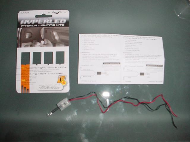

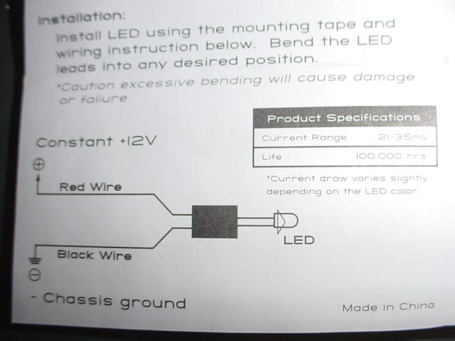

Here are the pictures, Basically, I would like them to light up when the lights are turned on. No need to have them on during the day, as it wont do anything. But I want a place where the voltage will be properly supplied. I just like to do my stuff properly so thats why I havent just wired them up to the battery or something.

Led lights draw so little current it doesn't matter. Just tap power to the red wire going to the parking light in the front headlights and the black wire to a good chassis ground.
