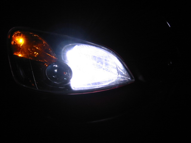

These pics actually do this kit no justice..........it looks 100 times better

Old Nov 19, 2004
ImPulse's Avatar
iTrader: (32)
Posts: 8,407
nice glad you figured it out
