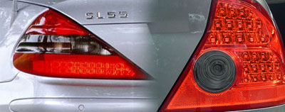

I' am not 100% done... The main problem with doing a custom led conversion is Heat... You dont want the leds to die or your tails to get messed up...
Anyways, Whenever I drive around at night time I basically look for cars that have LED tails then follow them , There are ways to make the leds either just stay on.... or blink for turn signal use. So, there are a whole bunch of wiring/technical things you gotta know
this is what i want my 04s to turn out like...
But, because of heat issue and all, I believe I will only be making the top "section" LED and the rest halogen. Still not sure.
