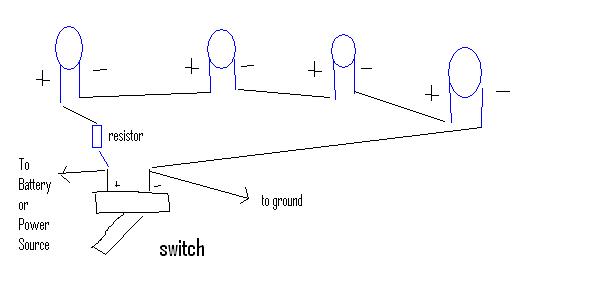

here is how i would do it, this is how i have my Neons done, it works fine for me

Hm maybe thatll work for me
thanks for posting that man, respect
