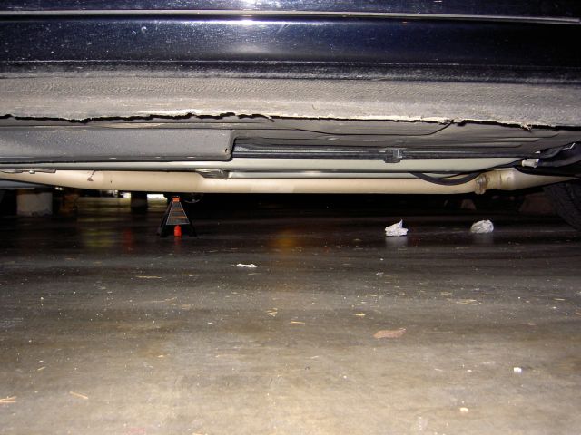

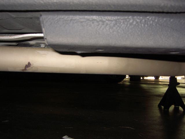

anyways, here are the pictures that was request
^left side's underbody^
^place where the "metal box" end^
^pic of where the metal box meets the front of the car^
^right side's underbody^
if you need more pic to draw on, let me know

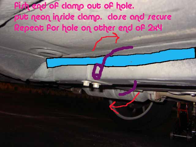

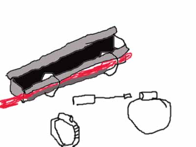

Nice! Let me draw up a schematic...
Buy these....
The size should be at least the diameter of a jar of peanut butter or a large mug... the larger the better... but not TOO big. Go to home depot and look around... get the medium-large ones.

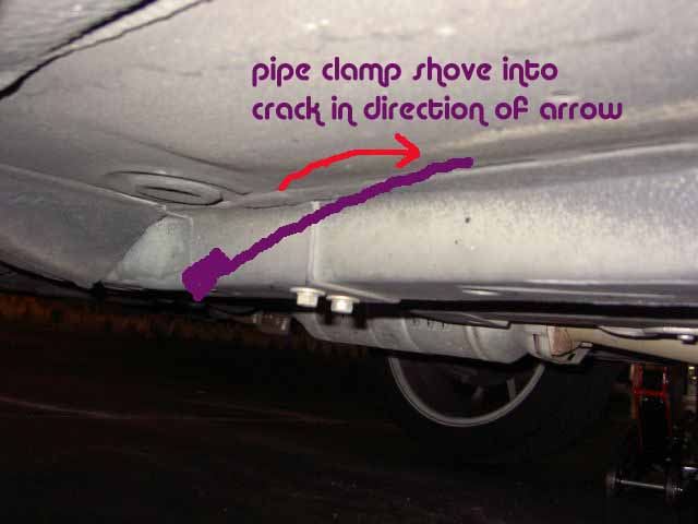

See the cracks? Pry at these (not too much) with a screwdriver just enough so you can shove the pointy end of the pipe clamp under the 2x4. The 2x4 will only be pried off about maybe 1 or 2 mm in that region.
The pipe clamp should be shoved between the 2x4 and the bottom of the car.
Only pry along the 2x4 where you see the big holes in the bottom. You do not need to pry the WHOLE thing off. See the 2nd crack that the middle arrow is pointing to? That would be your best bet because the pipe clamp will later come out of that hole that you see.

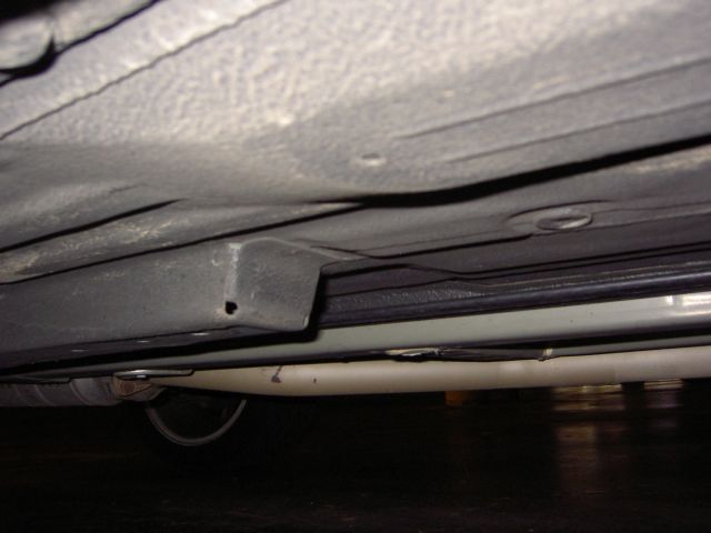

Here.....

Last one
