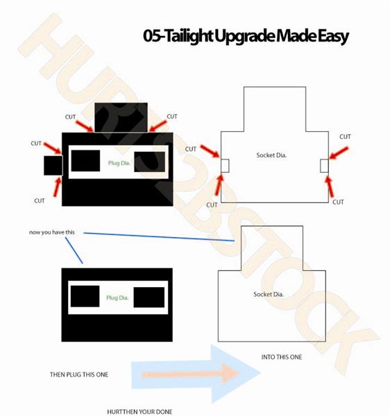

I know this is a semi-old thread and topic but, I couldn't find the adaptaplug thing.......so I just cut the plug to fit the new socket, it took about 45 seconds per plug and now they fit as good as oem ......
Name:	241 (Medium).jpg

^^ i just got my 05 tails today an i was going to buy the adaptaplugs tomorrow but i just saw your post and did it! i used an xacto knife to cut off the plastic and everything fits very tight. i wouldnt say its easier but it sure is cheaper! thanks hurts2bstock
hey!
that's a very interesting way to do it! however, its probably only for those whos willing to cut the pugs.....
