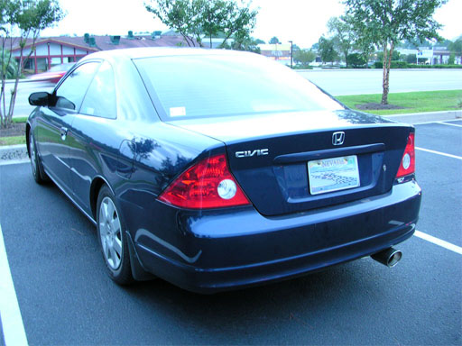

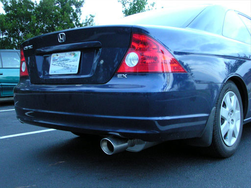

the socket part numbers were correct... they weren't listed the same on majestic honda.. thanks tho.. finished the conversion tho
Name:	New 04 Tails left.jpg
ID:	37367   Click image for larger version
Name:	New 04 Tails right.jpg

zen_master's Avatar
Posts: 3,784
nice!! =)
hope you enjoy the conversion! it's really nice.... =)
