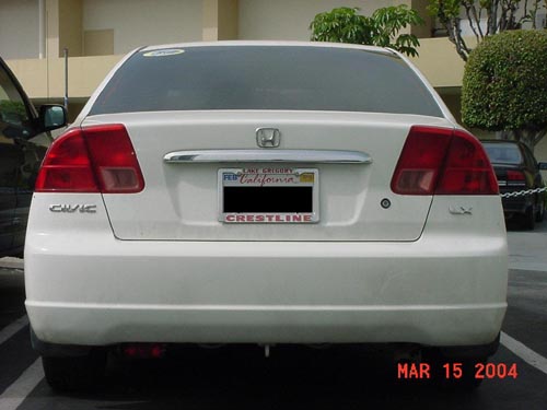

Let me try this again.
Here it is on.. notice it is brighter than the parking lights....

Old Mar 15, 2004

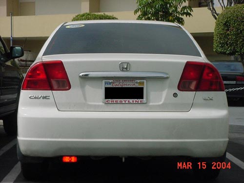

and finally here it is.... with it off.
I like it because you can barely notice it is there.
Again, my apologies for the mutliple post.. I just can't seem to add the link above.

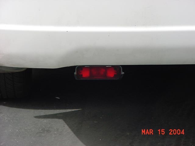

Well that the problem, the light is custom made.
I have been looking for the OEM light myself but had no luck.
This is the OEM look...
which is for the Civic Saloon 4dr in the UK.
I know there is the rear fog lamp made by Hella but I did not like how it looked.... then a buddy of mine gave me the light which is what I used and is great!
Attached is a closer look of the actual light... take a close look and guess what the light is for originally. BTW, I used 2 elevator bolts to hold up the light.

Originally posted by Bartkat
What is elevator bolts?
McmasterCarr.com
Also known as belt bolts, these have the largest head diameter of all flush-head styles. Ideal for industrial belting systems where head clearance must be kept to a minimum.
Look closely at the last pic above, I need to paint those flat round silver ends of the bolt to black. Oh yeah I also used nylon hex nuts so I don't have to worry about the bolts coming loose, I guess I could've used locktite but why do that.
