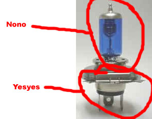

no, never touch the bulb with your fingers :x
the oil gets on the bulb, and when the bulb get turned on the oil burns on the light and will **** it up :x
dont touch the actual bulb.. u can touch the metal prong thingies

so if i did touch it then.. is there anyway i could clean it?
Old Feb 1, 2004
Rep Power: 811
You alcohol to wipe it clean.

Agreed on using alcohol for a cleaning solution. Also agreed that touching the glass surface of the bulb is a bad idea. Clean cotton ***** or q-tips for small jobs works as a wiper.
Blue bulbs also tend to die much faster than OEM bulbs do. If you are using aftermarket blue/generic bulbs, that could be a big part of the problem. Switch to OEM bulbs, install turn signals using a clean towel and headlight bulbs by the base without touching the glass.
If you continue to have the same problems after putting in OEM bulbs and not touching them take it back to the dealer.
