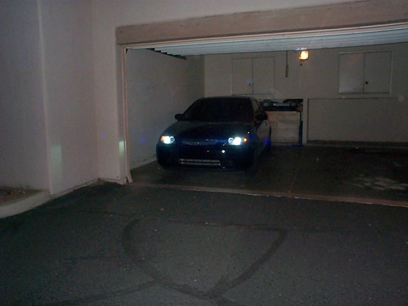

If you come to AZ I'll show you mine.
*******AUDI S4 HIDS**********
