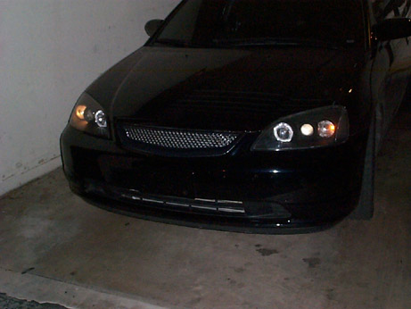

The Euro spec HIDs for $425 on that website ARE the Audi S4 HID (The exact ones I have in mine)
good job man i gave you an extra point with the rate button for that **** looks nice.
is that halos too?

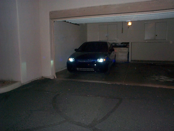

If you use the Sonar brand lights, the stock mounting threads (on bottom because the top is held by a stationary plastic ball) lined up perfectly with the S4 projectors. I just figured out the pitch of the threads, bought a tap and die set and threaded the holes in the projector. As for the top, the plastic ball setup wasn't going to work, but there were two thin metal tabs with holes so I tapped the plastic itself, put threaded rods through them (trip to Home Depot) with nuts on the end to hold the rod still and viola. The halo LEDS have been replaced with MUCH brighter ones too.

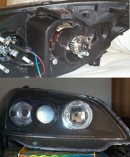

Voice, the stock projector photos you posted in another forum looked exactly like the ones I had. I'll try to find pics of mine before I put them in. The valeros look much bigger than mine. I've heard the Audi TT projectors are among the smallest available.

pic

damn rufus... you cut the ****in back up badly, LOL!
I didnt even cut the back of my tycs :x

My projector was so large I had to cut it. To be honest I never finished sealing it because I was going to wait to paint the insides and it has NEVER fogged up.
