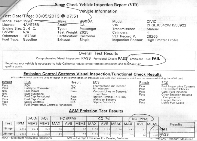

So, I failed smog. Visual Inspection ok. But emissions failed. The tech told me to first fill up with premium gas. after I've gone through all of the low octane and high octane flows through, come back and retest.
I asked, what if I use high octane, and still don't pass? the tech said: "it's your cat. it's probably old, but hopefully that's not the case. Also come back when it's cold. come back in the morning. your chances of failing are higher when it's hot and muggy."
I also asked: this has nothing to do with my header or intake does it? The tech answered, "no. Everything is hooked up just fine. Some techs will be a b**ch about it and fail you regardless of carb and paperwork, but you're fine."
I attached my smog slips. Do you agree with the tech? Is my car so old that I just need to start filling up with premium?
