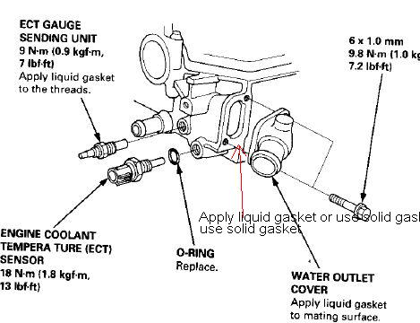

Hello All,
I'm leaking antifreeze in this area (pic below) from my outlet gasket.
I found this online and was wondering if it was better than using the liquid gasket?
Honestly I don't even know if the liquid gasket is suppose to go on the hose portion of the outlet or where the two surfaces meet.
