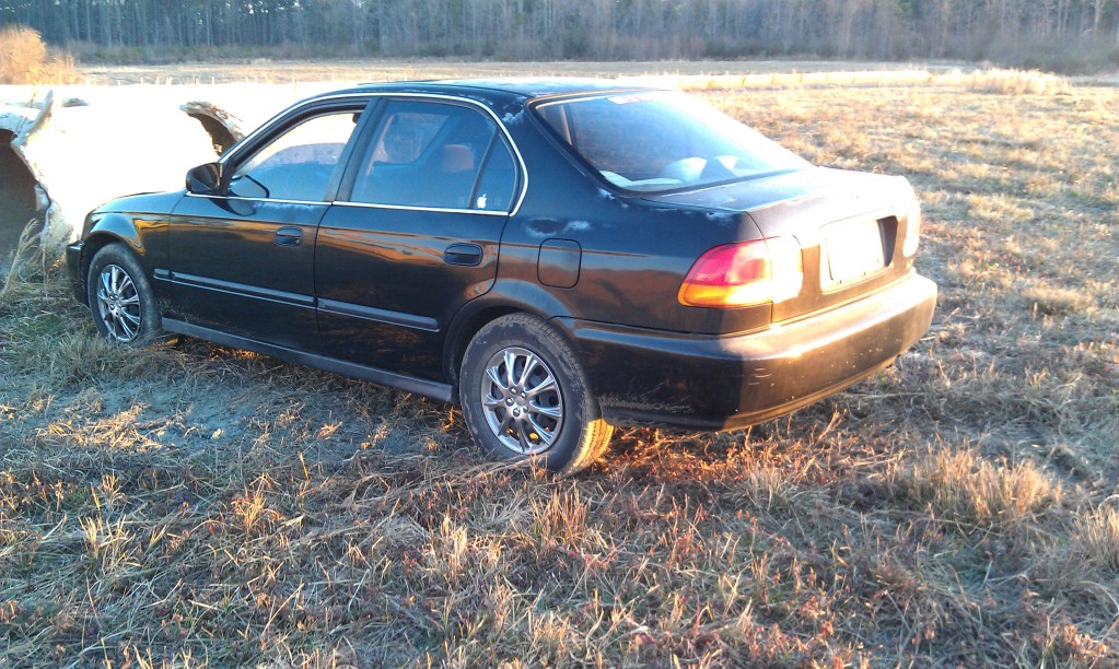

This is the dented up quarter panel and a small metal panel under the taillight...
