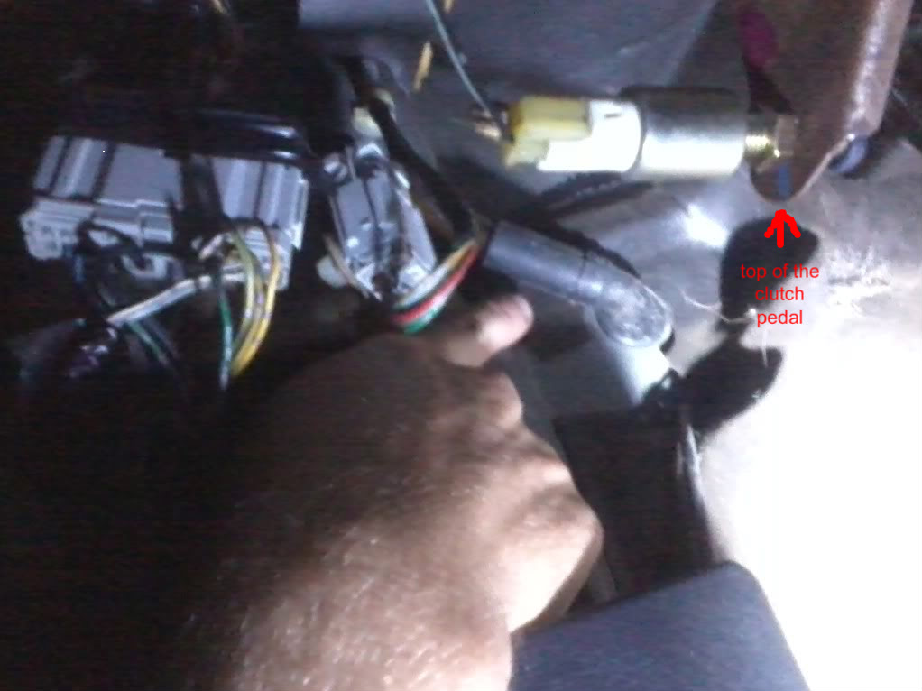

Check to see if the drain tube has become undone. It's in the driver's side pillar. Look under the dash at the pillar.
Here's a pic I took awhile ago of the driver's side tube:
Sorry about the fuzzy pic, crappy phone cam. And sorry about the angle, it's hard to get your head and a camera under the dash together.

Yeah, that's the drain tube leaking. You have 4 total- 2 up front, 2 in back (just pull back the side covers in the trunk).

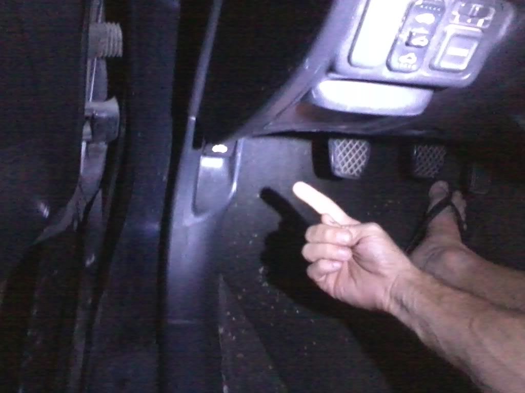

To find the drain tube:
See the kick panel with the hood release and the pocket with switches.

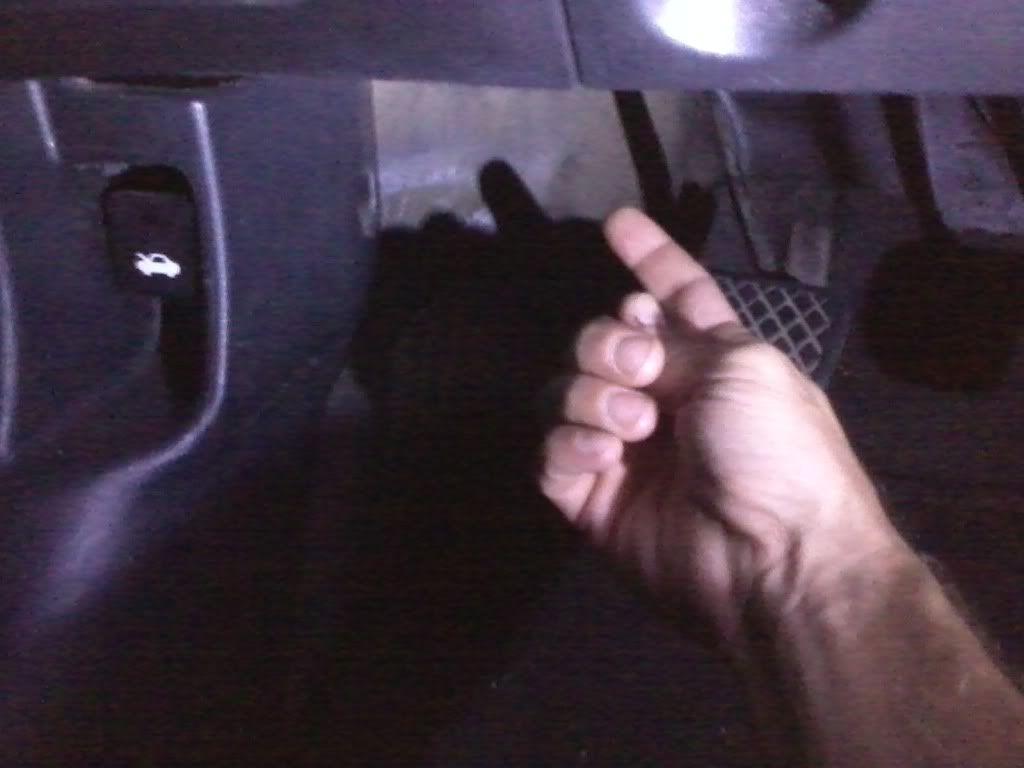

Look above and kind of in front of(front of the car) the kick panel.

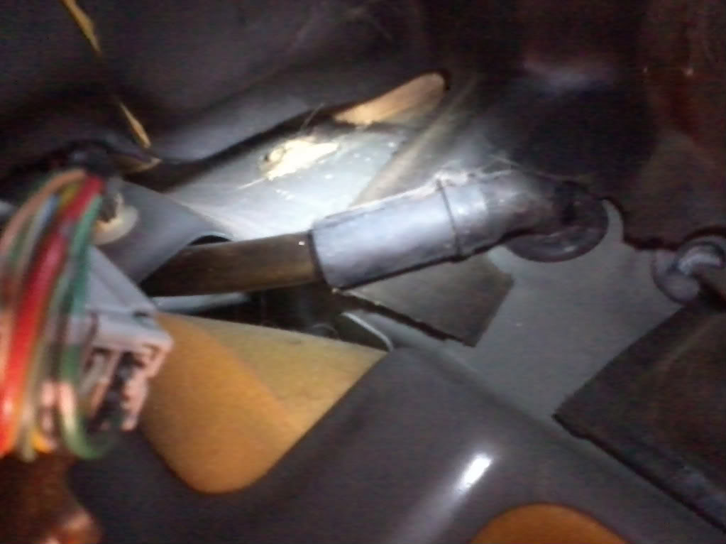

In the last pic you can see the top of the kick panel that you see in the other two pics below my hand. And that electrical above my hand is behind the pocket and switches. I'm pointing at the tube, it's running down the frame.
