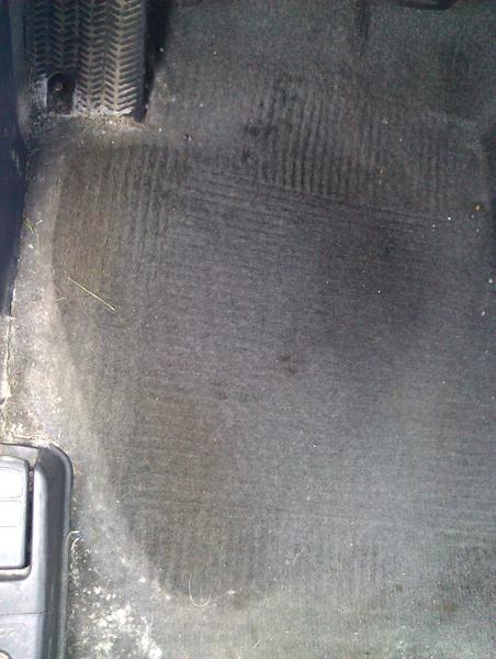

In the meantime, this is what the leaks looks like. Perhaps the pattern might give an indication of the leak source.

Yeah, that's the drain tube leaking. You have 4 total- 2 up front, 2 in back (just pull back the side covers in the trunk).

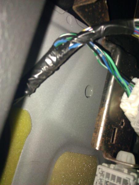

Yea, I for sure don't have that drain tube.

Do you have a moonroof?

^^ LX doesn't have a moonroof.
@ optimi: I'm stumped right now, I'll get back to ya.
Old 06-14-2011
Whachya lookin at?
BlueEM2's Avatar
Join Date: May 2009
Location: Canada
Age: 38
Posts: 6,388
Received 11 Likes on 7 Posts
Rep Power: 288
Re: '02 Civic LX Water Leak
Laz I'm pretty sure that's a moonroof drain and he won't have it unless he has a moonroof. Look underneath the car for any kind of floor damage you might see. Also check to make sure the plastic door panels are intact... I'm stumped too... Remove the kickplate to see if there is any moister underneath it. I'm betting it has something to do with your floor though If you really can't find it you may have to remove the carpet to see where it's coming from.
