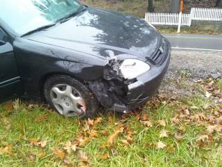

Here is my car after a fun time of trying to take a 20mph turn at 40mph on a wet road. Hooray for loser skillz.
After looking around the interwebs for parts I came across a '96 honda civic dx car that is being parted out. The car I would like to fix is a '99 ex coupe. I was wondering if the parts for the '96 will fit on my '99.
Answers and lolz are much appreciated.

there was a facelift in '99 that involved pretty much a revamp of everything on the front end (bumper, hood, headlights, grille, fenders), so I'm gonna say no. Unless someone knows otherwise..

Correct, '99-'00 only. There are about 10 in your town being salvaged, search by zipcode: http://www.car-part.com/index.htm

Thanks for pointing me in the right direction. Saved me $200 at the least.
