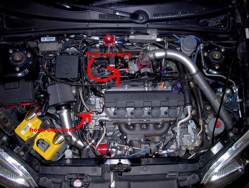

coolent line to turbo
the turbo kit im getting comes with a braided line to run coolent to it on glo shift i found a water sender adapter where u cut your coolent house and clamp this in between it and so you can run your turbo coolent line to that the ? i have is does anyone know what size an 04 civic ex upper or lower radiator hose size is there are a couple options Thanks

The 2003 has a 28mm OD hose, so I would imagine the 2004 is the same. That being said, I would just use your TB lines instead. Just pull the top hose (the return line) off the TB, run your turbo water feed line from there and then plumb the water return line from the turbo back into the water neck on the head. Like this:
I changed my setup later on, but this works just fine.

This is the easiest way I found....

heh great minds think a like!

al right looks good now i just have to hope i can tune with my vafc2 and acura rsx type s injectors thanks
