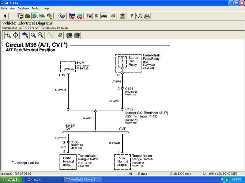

here ya go i think....
best i can tell it would be Blue/white C12 position

Re: Need help!
if you want i can e-mail you the picture its bigger

Re: Need help!
her is the picture in case someone else needs it

Re: Need help!
Ya but the C connector doesnt exist on the manual engine harness. So do I just need to cut the connector off the old harness, plug it into the ECU and then ground pin C12? Cause we tried that and It still wouldnt crank.

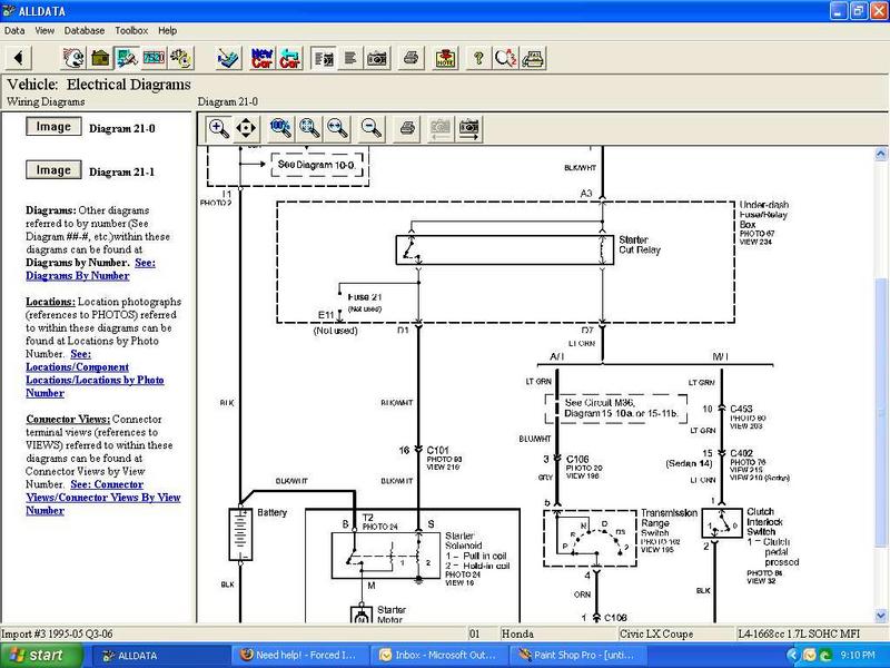

Re: Need help!
follow the circuit...

Re: Need help!
my guess is your grounding it between the relay and the ecu?? and it needs to be grounded after the relay between the relay and the A/T shifter???

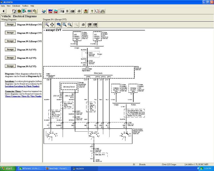

Re: Need help!
Green wire is on manual trans cars from looking at the picture. im assuming edrulz2003's car was a manual trans car to begin with?????
