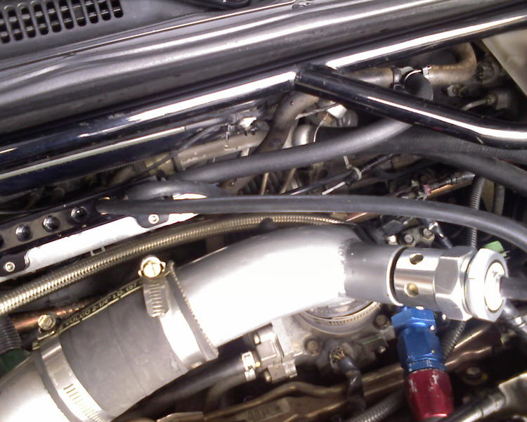

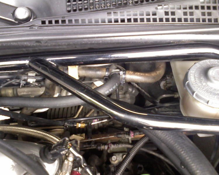

Here's where I tapped the line

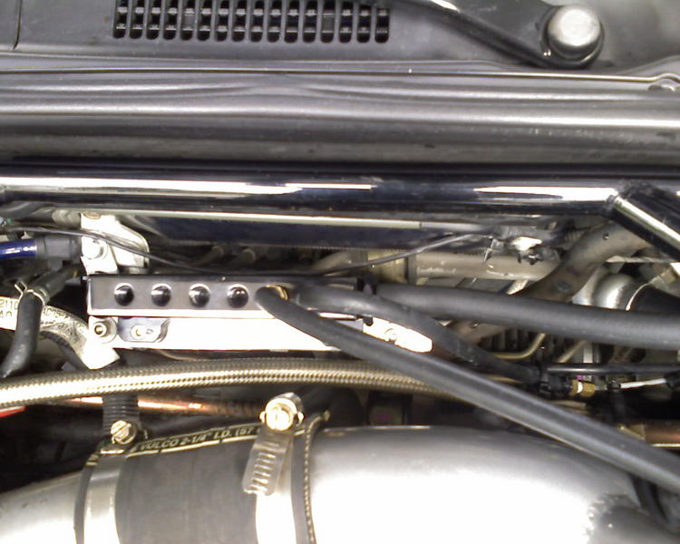

Here's the connection to the vacuum mani with 2 lines tapped
The whole setup

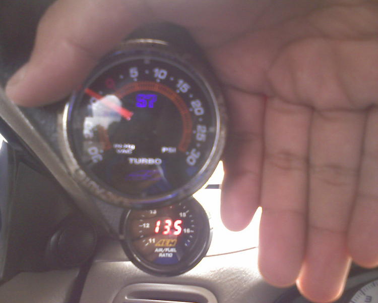

Car idle, neutral, no clutch

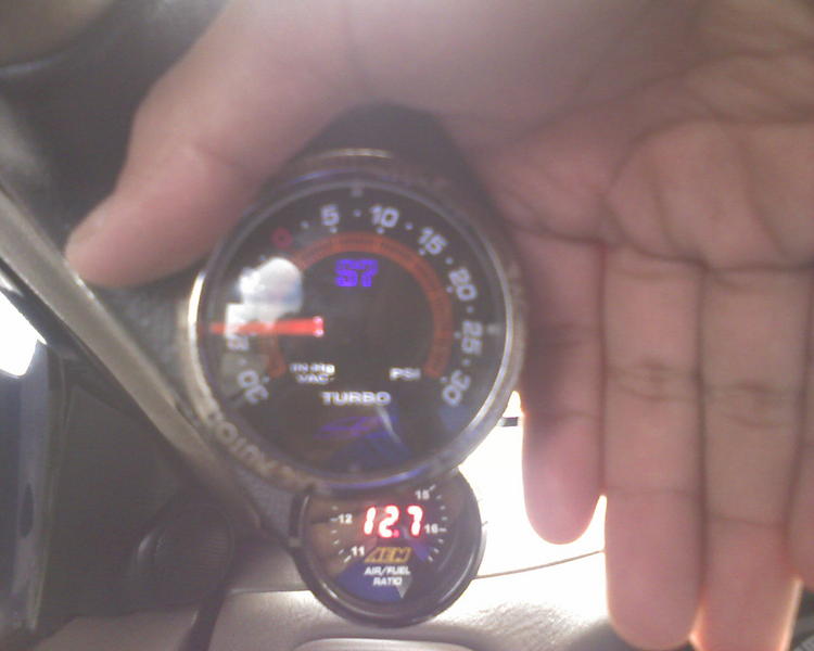

Car idle, neutral, clutch in

clutch shouldnt affect the reading. something isnt right. i would double check all lines and whatnot. im not sure why the clutch is changing the reading.

You tapped the master vac on the wrong side of the check valve. The T needs to go on the IM side of the valve, which is under the white clip... feel around in the line, you'll find it.
Splice the line back together, cut the line on the other side and tap into it there.

bah... I felt around but didn't feel anything so I figured the check valve was internal to the brake booster..

So, I fixed the problem.. I pulled the tee fitting golden eagle supplied, installed a 3/8" brass fitting used for air hose repair, and tapped the brake booster line after it bends and goes downward. Well, it works like a muthafukin charm! Woo!! lol.. The clutch still causes a momentary spike in the boost gauge pressure and still continues to boggle my mind, but as long as it doesn't hurt anything, it's no big deal. If anyone can give me insight on why the clutch does that, let me know.. Otherwise, this thread can be locked if you uber mod types wish
Oh, and apparently I missed the check valve by just about an inch.. lol.. when I pulled the tee off, I was able to see the blue color of the check valve.. lolo..
