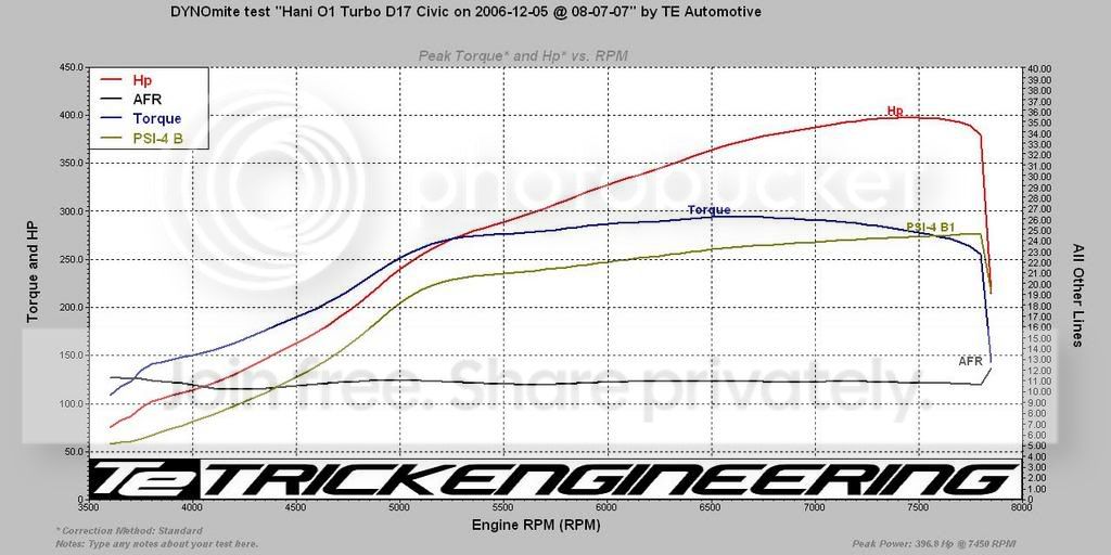

HERE are some pics of a customers car we just built and tuned 01 civic with the D17 engine , custom TE turbo manifold , AEM EMS , 750cc injectors , 3 inch downpipe to 2.5 inch Exhaust for now!
Pics are crappy but some how I lost the good ones !!
I will have Dyno sheets soon posted!!!
Car made
330HP @ 15PSI 255 TQ
366HP @ 22PSI 282 TQ
393HP @ 24PSI 292 TQ
93 octane pump gas
would have made over 400HP easy but I think 396 was good for a SOHC
what do u guyz think on the #rs on this.. it was built/tunned @ local shop
idk the hole story... there is no dyno yet.. but this is what they r saying

here is TE Dyno data

thought it had 360 wtq? Still nice numbers, finally dyno proven
