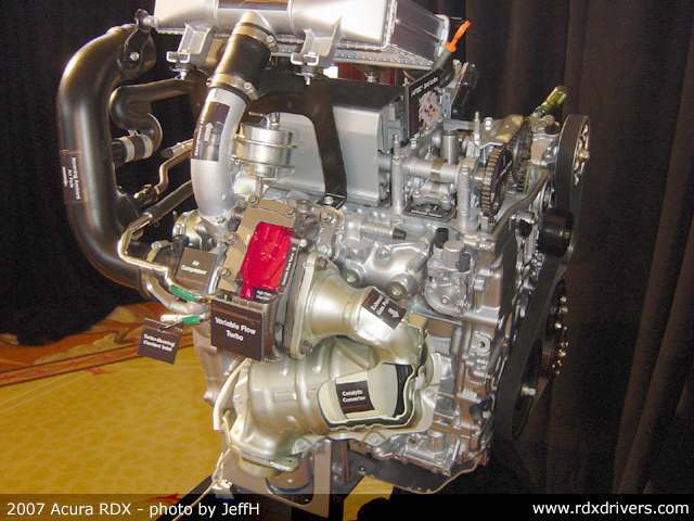

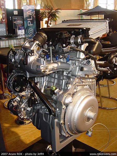

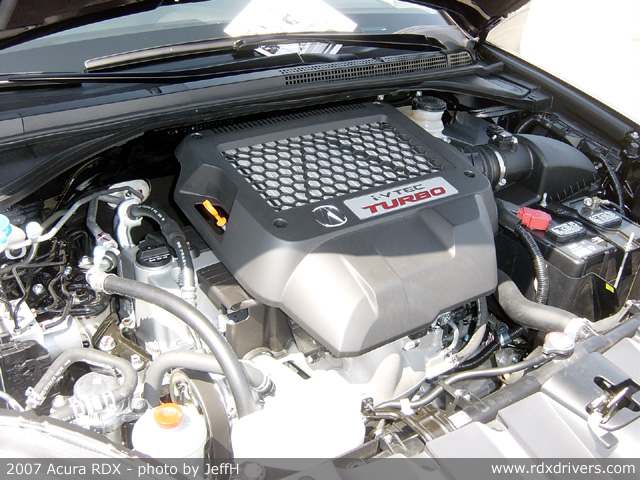

I don't think it would clear the hood at all unless you have a custom FMIC setup but i was looking at where the transmission mounts and looks weird would a rsxs tran fit on it at all with a custome adapter of some kind. maybe skunk2 or somebody can fabricate that IM with the throttle body facing down. that cam looks diffirent from the 3 lobe cam from the rsxs. anyways their is still the problem of having custom motor mounts
http://www.rdxdrivers.com/forums/index.php?topic=29.0
ID:	68700   Click image for larger version
ID:	68701   Click image for larger version

this would fit because a few items
the mounts are diffrent from a standard k20/k24
custom intercooler needed
it uses a 4wd automatic transmition. you need a k20 transmition to fit in a swap
the head is the same as a k20a3(si motor), it does not have full 3 lobe I-vtec cams
its basically a 86mmx99mm 2.3 liter. which is a debored k24 (87mmx99mm)
you can't put the pistons in a k24. maybe the rods. but its probably cheaper getting aftermarket.
it would probably be cheaper to do a k24a1/k20a2 head and slap a turbo on with better numbers
