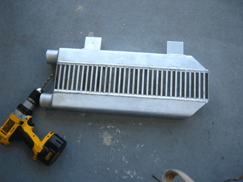

Well, Mark finally finished the first 2 after some weeks and months of busy schedules, trials and errors, supplier hang ups and personal issues. Here it is with no further adue.

I want the drill.
Looks good man!

I want the drill.
Looks good man!
DeWalt 14.4V Shop Drill.............Niiiiiiiice.

Maybe I’m a novice but why does it look so different?

Because of the new bar and plate design for it to flow much better than the V2 intercooler.ITS IS SICK!!!!!
1.) It's new bar and plate technology released last year at Sema.
2.) The design is top to bottom flow w/ custom made end tanks.

So about how much more flow does this give? How much more power would this give?
This should realisitcly support 300HP. Prob not much more than that.

300hp as at the wheels or motor?

looks nice. i can tell that the fitment is going to be a hell of a lot better than most of the other intercoolers on the market as well.

wow no one even asked what kind of core it is or what the dimensions of the core are Looks good dezod, core just looks really small, maybe its just the pic and what kind of core is this?
And whats the size on the inlet and outlet pipes?

How is this design better than the other regular designs?
300 to the wheels would be a stretch.
Bar and plate technology. It is the same one we have been running on some 1000WHP Buick GNs, our 300+WHP tC, MR-2s etc. The core technology was released last year at SEMA.
The core it'self is 5" H, 3" D, 22" W which is a surface cooling area of 330
Inlet and outlet are 2.25"

300 to the wheels would be a stretch."
Edit: I take that back, this intercooler flows about 495cfm, which according to rough calcs, 350 crank HP would be the mark. This means 300whp will be the cusp of a new intercooler being needed.
