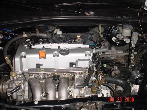

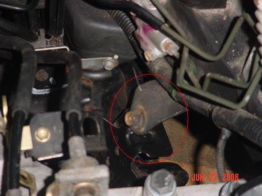

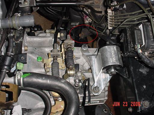

Well the K20a2 does infact fit into the civic engine bay . I know that it has been done many times, but trust me upon aproach you begin to wonder. Well it is 3:15am and I just put the last bolt in the subframe. I have to work at 7:00 am. I love DIY swaps

OK, OK LOL I will take some pics and post them
The engine went in from the top. I had problems clearing the ABS and the tranny mount bracket. I had to lower the tranny side alot and lower it in at an extream angle.

Yes those are the parts that I have in my sig. I will take some pics, but as those of you who have done it can attest it is a long enough process and sometime taking pics and documenting is the last thing on your mind.

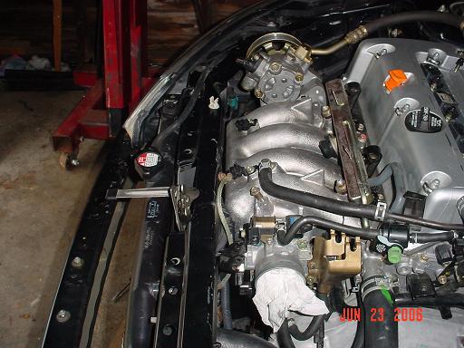

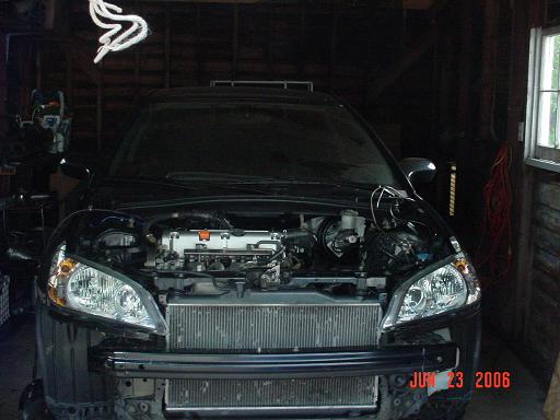

one thing that I did notice is the RSX subframe bolts up just like the civic except for these two brackets that use to attach to the old subframe don't have a home. What have others done with these two brackets?? do I need them?? (you can see them circled when you double click.)

mines are just hanging there also... and the other swaps i have done also are just hanging there too.. lol

^^^^Funny, how you did not say if it was correct or not LOL . How did you do your fuel lines? I am to cheap to pay for the rsx ones from the dealer so I am going to use goodyear fuel injected line hose, the d17 clip on the fuel line and a fuel line hose clamp on the rail. I am going to try to get the line on the rail over the bead and then clamp it, but I am still a bit concerned about leaking.

lol... if u read my DIY i didnt even use the rsx lines they tell u to buy... waste of money and time... just take the clips off each end of the original fuel line and buy

^^yeah I read your DIY. The clip that goes to the fuel rail was broken on my engine. To get a new clip you have to by the entire lines. So based on your experiance do you think a clamp will work. I can't have it leaking because I wrapped my header. That fvcking thing would be a gaint wick if gas got on it.
BTW the Rsx radiator was a bit harder to fit in my car (required a small amount of cutting). The ECU was insanley hard to remove, and I wish that I would have removed the dash. I honestly was begining to think that you had David Blane helping you with you swap LOL

yea.. i know i mentioned it somwehre.. dont know.. but the EP and RSX radiator will fit perfect especially if you have a body kit.. but may require some trimming around the bumper area if u still have the stock bumper..

it was not anything with the body it was the framing that the radiator goes in. I had to cut it to get it in period. The stock bottle did not fit either, but I found a solution to that and I think people will like it alot. I will post it up when I am done. I would not want to ruin the suprise LOL
