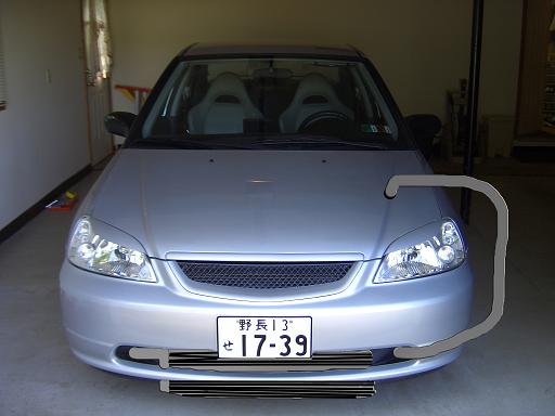

I kept my AC by routing pipes outside of the car!

^^MWHAHAAHAAHAAAHHAHAHAHAHAHA
looks like the snorkle on the old jeeps

diskreet, you always have something funny to say!
I still remember your comment about supercars and universe...
Repp ya buddy.
