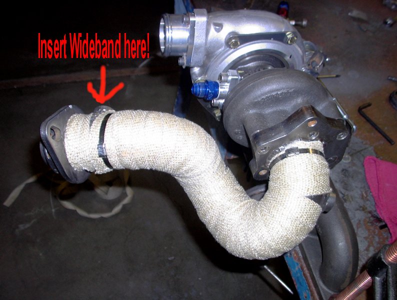

i THINK 18" min is recommended. My wideband is at the VERY bottom of my downpipe off of the turbo

Within 12" of the turbo. Mine's prolly about 8" down.

here is where mine is located at......
