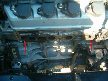

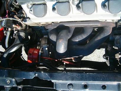

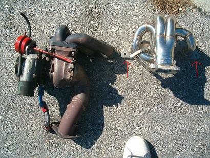

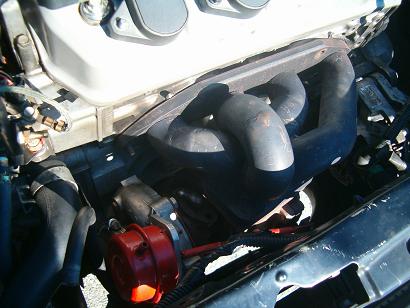

ok time to put my foot in my mouth
took the whole stafford setup out today, and tried to drop just the obx mani in., first off it dosent even fit onto the head. its got clearence issues with the head ( i drew a red arrow to show where it was hitting )
second off, you guys are right, a new downpipe, charge pipe, and oil drain would be required. i took some pics showing that the obx mani would have the turbo sitting about 3 inches lower the the SF mani.
im not about to do all this modding with the thought of the obx mani cracking in a month in the back of my mind, oh well. im gonna clean up the SF mani and throw it back together.
if anyone is thinking about using this manifold, get ready to grind about 4/32 off both sides of the plate that bolts to the head so it will clear.

dam, well then i guess it isnt worth it. nice visual!
