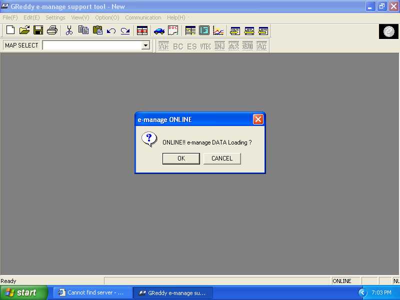

here is what i get from mine soon as i turn the key on.....
Old Jul 17, 2005
tfnaaf's Avatar
BLDNPSI Mod
Posts: 3,318
From: Boise, Idaho
Rep Power: 329
then after i click ok, it loads then the map buttons go from gray'd out to clickable to view

okay lemme give that a shot.. lets see what i get
Old Jul 17, 2005
tfnaaf's Avatar
BLDNPSI Mod
Posts: 3,318
From: Boise, Idaho
Rep Power: 329
if you still have no maps available to look at.... Did you go into settings and set it up and select what maps you want available? If you do make sure to not change the injector ratio unless you have the bigger ones installed
Old Jul 17, 2005
XSRCivic's Avatar
Posts: 2,351
From: Houma, Louisiana
Rep Power: 306
XSRCivic is just really niceXSRCivic is just really niceXSRCivic is just really niceXSRCivic is just really niceXSRCivic is just really nice
i get no kinda of message box like that. I turn the key on.. its online but my maps aren't clickable. perhaps the maps arent loading?
