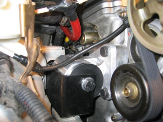

i used hasport mounts and i had to custom the passangers side. most of the stuff in my car is brand new from honda, which raised the bill a couple g's, im not disclosing how much it cost, but it cost alot....

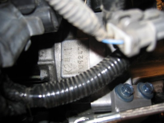

K24a1 block

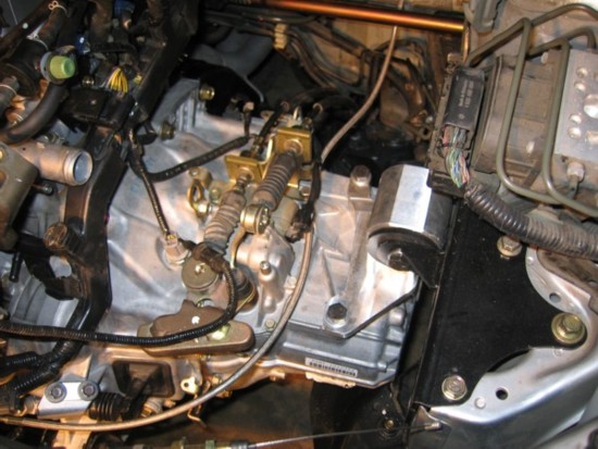

rsx S 6 tranny

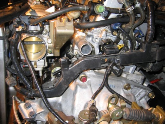

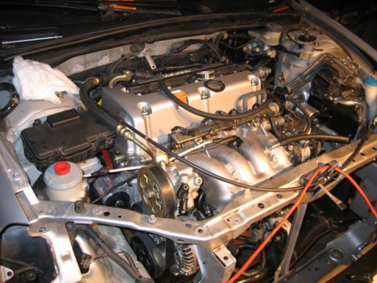

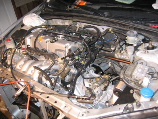

ID:	52105   Click image for larger version

Name:	custom mount.jpg
ID:	52108   Click image for larger version

looks like a tight fit. Were you able to keep the stock fans and radiator? Do you think there would be any room left for IC piping and turbo?

haha... yea.. sorry... it is a tight fit, but.. there is a **** load of room in my engine bay compared to a rsx or si... i compared them on friday night at a showstoppers meet... if i don't put a a/c in, i willl have alot of room for a ic... and the rear of the engine has sooo much room... i have soo much room in the bay... even with a k24

i didn't use the stock radiator and fan, i used a si radiator and fans... and a rsx radiator reserve tank
