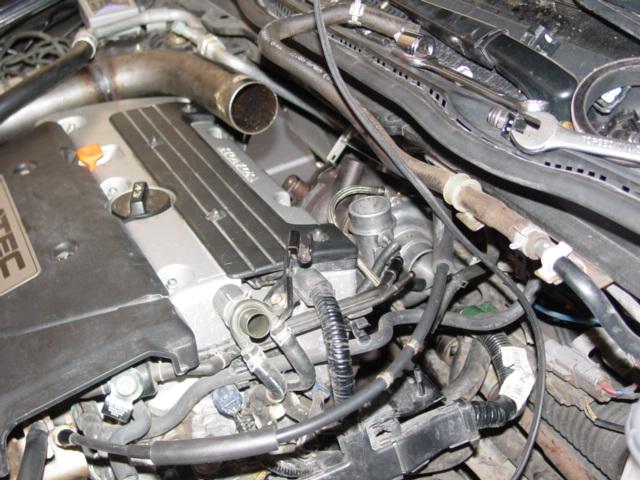

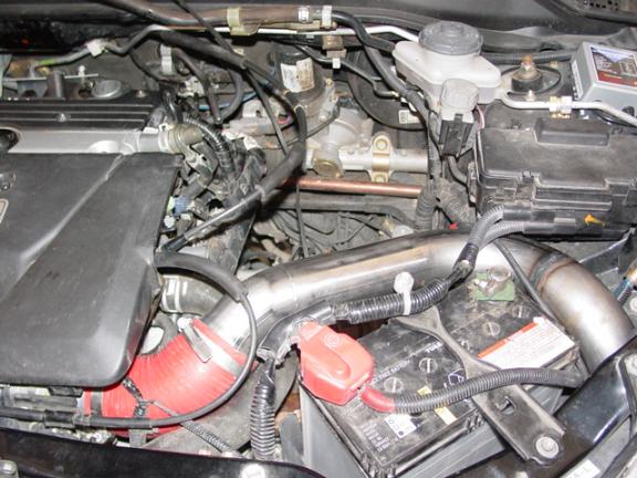

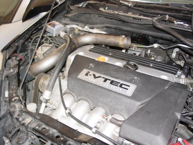

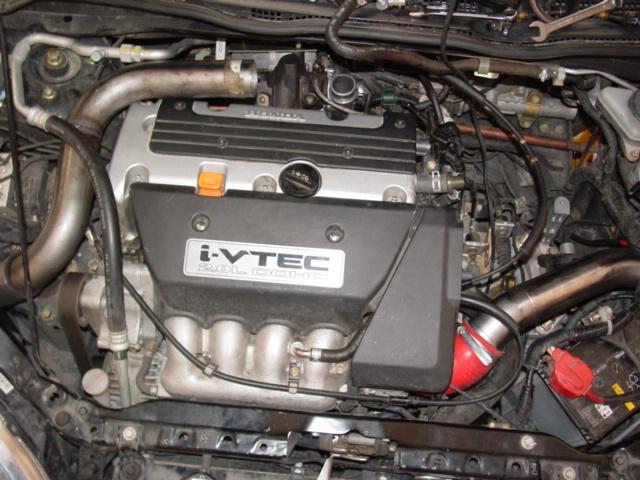

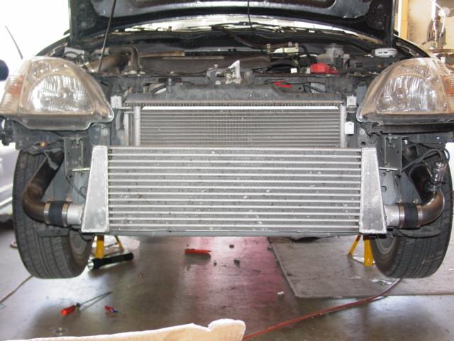

Look whats in my garage....
Weve been working on my friends 03 si. Its been turning out quite well.
Tell me what you think.....
