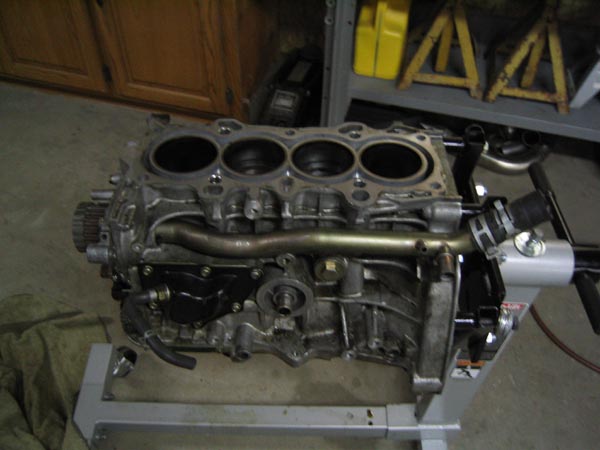

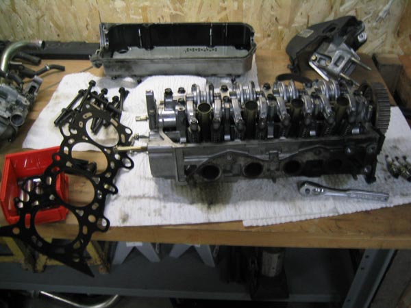

yeah, i know...been there twice, but this time i am doing it right...ever since i took off my turbo kit, i have hated my car, and kinda gotten out of the car scene, but the urge is back, i cant stand it...you cant hide what you really love...i am going to boost my civic again, except this time it will be after i get my other block back from being built...i have it ready to be shipped out for bore and hone, sleeves, pistons and rods, and i am going to do a mild pnp on the head...in the meantime while that is getting done, i am going to be fabbin up my manifold, if i dont get the SFP mani from SLP....i already have the return fuel conversion so i am now looking for some type-s injectors(if you have some to sell, hit me up...)will be tuning with the emanage since that seems to be the best way for use right now...
sorry for the absence....
here are couple of pics of block during dismantlement....
