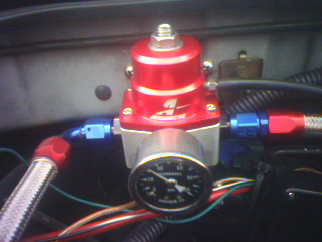

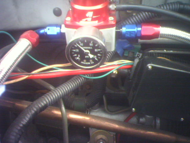

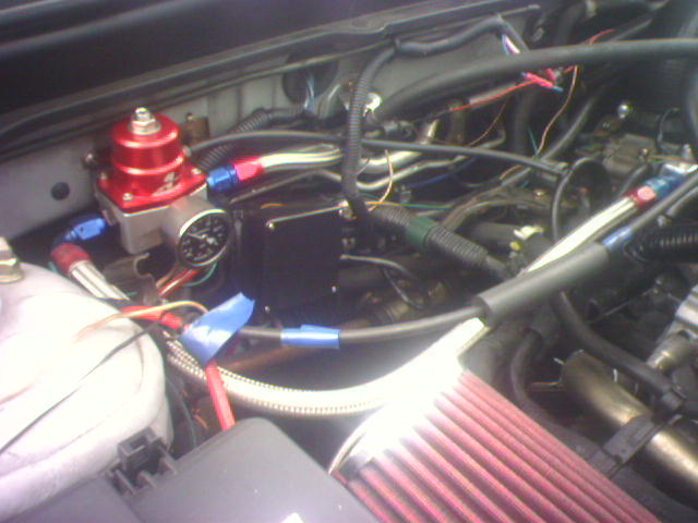

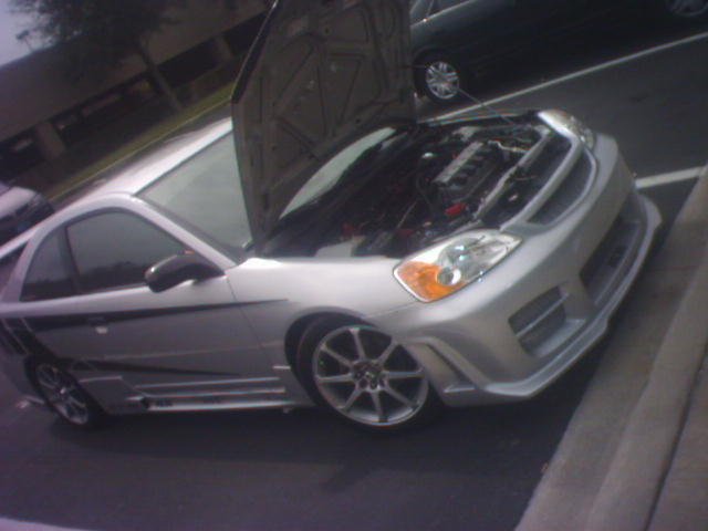

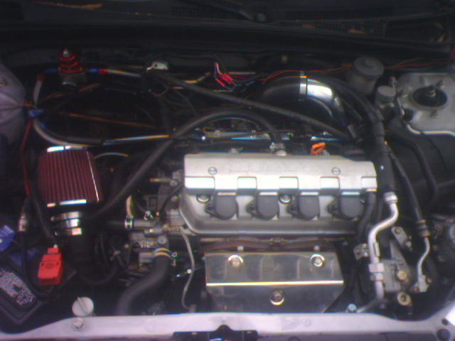

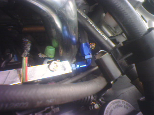

These are some pics!..........................
GO ahead with the comments.
haha
(Quick Explination on how it works)
Fuel from pump go's to External FPR... FPR go's into the rail, from the other side of the rail *extra fuel* go's back into the back of the FPR and then circulates all over again!......

Originally Posted by Alex1
nice pics
Thnx man, Hey can you c the setup a bit clearly?.....lol
Its one of those SideKick Camera's.. So its not to clear?

Im awaiting a technical explanation on PROS and CONS of this fuel setup.

at BEST it will only regulate the pressure to a LOWER ammount than stock pressure. I see ZERO benifit in this other then the mechanic that SOLD you it made $$ ! Unless they removed the stock pressure regulator in the tank? But then i see the line going in one side then out the other as i recall that regulator the side ports are common and not regulated from one to the other, and if this is the case then ther eis NO regulation in pressure what so ever. All your doing is using a pressure regulator for a place to mount the pressure guage. On that regulator the "Return side of the regualtor" is the Bottom of it.

what is the purpose of the fpr when you cannot raise the fuel pressure cuz the stock in-tank fuel pump has a built in fpr.
Congrats on beein the 1st one to have a negative comment about it!.... I already explained it to a cpl of ppl by phone.. (and they understood) but it kinda looks like you ***knw what you're talking about ***
Well, it is freedom of speech... I'll just leave it as... My car Is running perfect and no codes are been shot at me,no stuttering, no smoking....

BudDyLeEBoOsteD has a little shameless behaviour in the past
oh yea... btw....
The Return is on the bottom ...
( you just cant c it cuz the way I took the pic!.....
but, its there )
oh yea... btw....
but, its there )
So if the return is on the bottom what is the other side disscharge port going to ? And did they address the intank regulator? Im not being negative YET cause i dont see all the facts yet!

Rep Power: 414
haha, aite we cool then!
Answer the question.
Pictures of the setup does not confirm that it works in the way you intend it to work. Anyone remember the supposed "turbo carbon fiber 7thgen" from a few years ago that didn't actually use the turbo?
If its proven to work, then its a great alternative for people. Until is has been proven, then you will be doubted over and over by all experienced people on this forum...
Perhaps a dyno chart w/ a/f map and psi readings would be proof?
oh yea... btw....
but, its there )
Ok - this doesn't make sense how this thing is set up.
You have fuel coming into 1 side of the regulator, out the other side, than going into the fuel rail. The other side of the fuel rail goes to the bypass port on the regulator?!
If this is how its set up - that man, this is really a WIERD setup! This isn't how aeromotive intended this regulator to be used:
.) I'm trying to plumb my stand-alone EFI regulator properly, where do I put the regulator, before or after the fuel rail(s), and what ports do I use?
Unlike a standard or “dead-head” carb regulator, which controls pressure between itself and the carburetor, the bypass regulator controls pressure between itself and the pump. Therefore, the correct EFI regulator location is after the fuel rail(s) whenever possible, promoting the required fuel pressure, flow volume and velocity through the fuel rail and to the injector inlet, at all times. Most Aeromotive EFI regulators have two inlet ports, one on each side, and one bypass port, on the bottom. Either inlet may be used with a single fuel rail engine, both inlets with a dual fuel rail. Any unused inlet ports must be blocked with the appropriate port plug. The ideal flow-path is: out of the fuel pump, into one end of the rail; out the other end of the rail, into the regulator side port(s); out the regulator bottom port, back to the tank at the top. Dual rail applications should employ a Y-block to split the supply line before entering the rails, then individual lines are run from the opposite end of each rail to each inlet port on the regulator.
Taken from their web site...
I'm not to going to claim that I'm an automotive genious - because I'm not. I haven't repaired cars for 22 years, or had any other domestic crap to work on for my 27 years of life - but I do know a few things. One of them is that this setup is ****** rigged - pure and simple....
Have fun with it until your motor blows. I just hope some of the other sheep on this board don't fall for this retarded set up because there will be a lot of sad "kids" out there blowing their motors.
BTW - how old are you any how? That's not a derogatory remark, just a quesiton. I am just curious to know since you act like you are 16 or something.....
Oh yeah - you shouldn't talk so much trash for someone who had their MECHANIC set this up for them.
