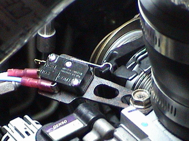

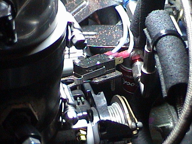

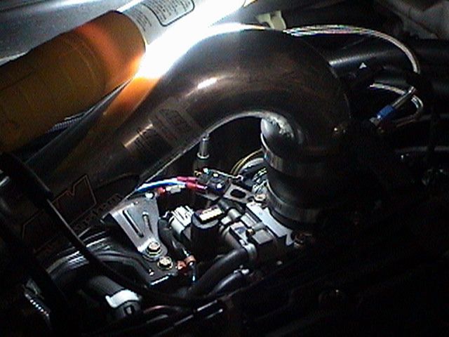

Can you guys post a picture of how you monted your WOT switch for No2? Thanks!

Here's my wot microswitch from an Edelbrock kit. I used a hacksaw and a file to cut off the oval at the end of the bracket to shorten it. I had to bend the bracket a little to line up the arm of the switch with the throttle lever.

thanks, those are good pics!
