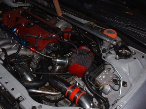

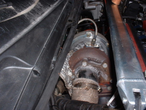

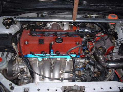

Hi guys,
Well for the past couple of months, ive been revamping my current turbo setup. I had a Cybernation kit on there, but i wasnt satisfied on how it came out, so i decided to redo the entire kit:
Precision turbo gt35 turbo, precision turbo intercooler, stainless steel piping, Thermal r&d turbo back 3", hondata k pro, rc engineering 750cc saturated injectors, 10 gallon fuel cell, aeromotive A-1000 fuel pump, 2 aeromotive fuel filters, tial 38mm wastegate, manual boost controller, etc.
So anyways, i have two problems so far.... One, my VSS is fubared and has to be replaced. No big deal. And two, the GM 3 bar map sensor is working properly with k-pro. We'll get that situated soon enough. So for now, we are running right around 10 psi and we hit about 342-343 whp on pump gas (93 shell V-powah ). Im not really sure, I was so entranced by the car's sound, i really didnt pay much attention. Basically this was just a test dyno on how well the car ran, because more boost is gonna be on the menu soon. We had some problems with the k-pro in the past, but since we replaced the harness and got another k-pro, everything is smooth sailing. Im really happy with how everything has come out so far. As soon as I get the dyno sheets, ill scan them in. The guy who has tuned my car still has them and we didnt get home till about 4 am Sunday morning, so give us some time..... Thought I might just want to share this with you guys.

clubrsx is probably gonna hate me for this but oh well.....
Hope you guys like

i hosted the pics on clubrsx, but i dunno. I think i maybe linked them wrong...ill try to host them on here.

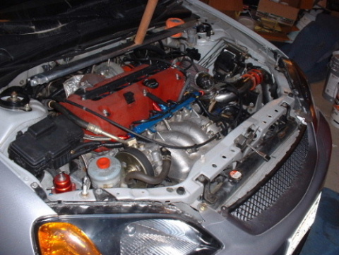

Yes, the complete motor is built. It has sleeves, lowered compression pistons (9:1), and forged rods.

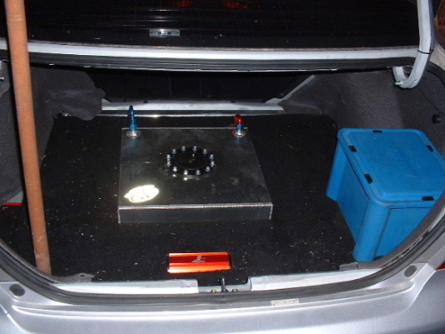

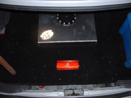

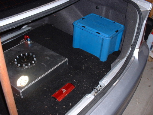

And the fuel cell is a 10 gallon. I think stock is 12 gallons.
