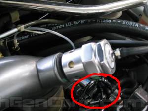

Old Sep 5, 2004
civic01vtec's Avatar
Posts: 30,677
From: Dallas, PA
Rep Power: 608
here, it is located where your Map sensor is.........
Name:	IAT sensor.jpg

^^^does it tap into something? my SF kit came from RSCIVIC...
where can I get this if I don't have it yet? I appreciate your help civic01vtec any sites can I buy this off? or any pictures online that you guys know about?
thanks again you guys!!! :beer:

Ok, the IAT sensor Does Not come with the SF kit. It is stock and is located in your stock air box or if you had a CAI/SRI it is located in the pipe with a rubber grommet. In order to install the turbo kit, you had to have removed the IAT sensor. Go look at your stock map sensor. There is a couple wires coming off of it. Look for the one hanging around. It has a harness with a sensor plugged into it. The sensor is a skinny black thing....about 1 inch long.
I wish i had a camera to take a pic.........anybody else have one ???
ok now i know exactly what you talkin about... so I have to unplug this and just tie it around on something? this should fix it right?
