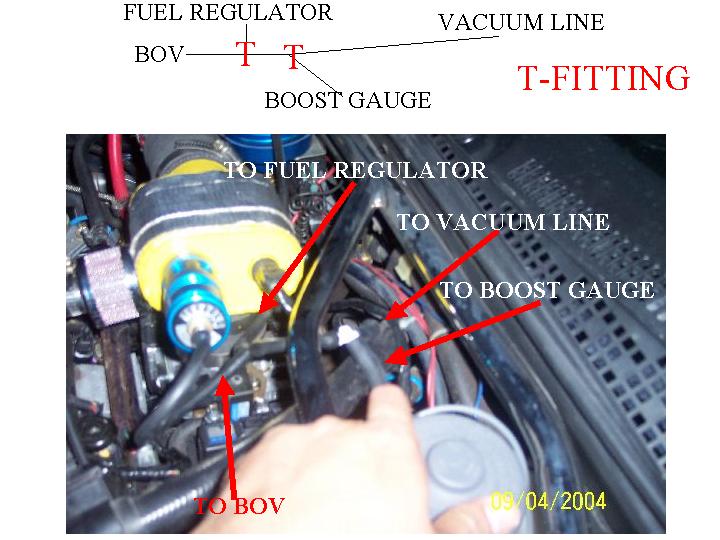

i got the boost gauge working now but, i'm not sensing any boost at all... just VAC@ 15PSI
here's where I ran the hose...
COMPRESSOR HOUSING--TO--boost controller
ACTUATOR--TO--boost controller(I tapped a Tfitting in between that runs to the 5 line Tfittings)
FUEL REGULATOR--TO--5 line Tfittings
VAC LINE--TO--5 line Tfittings
BOOST GAUGE--TO--5 line Tfittings
now the boost gauge work, but not sensing boost, it's on 15PSI VAC, I have a MAP/BARO CIRCUIT HIGH INPUT (CEL through a scanner)

Old Sep 4, 2004
pnoyster2k1cvic's Avatar
Balut Eating Champ
iTrader: (29)
Posts: 3,568
