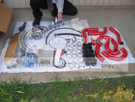

Pics of New SF kit. Are parts all here? HELP
the kit
Exhaust manifold
inner exhaust manifold
TURBO BIATCH
More of the kit
Downpipe
More of the kit
Various Pieces
Bent FU(KING pipe
Rallye Red pipes
More of the kit
Bent FU(KING FMIC
scratch on pipe
Metal shavings from the turbo

DAMn...seems like a used/new SF kit
welds look so amatuer too. I thought the were pro. I'd be a little heated...sorry I WOULD be heated about the bent Shyat. Too mcuh money and a wait to have stuff come like this. At least you got it. I didn't see anything missing...checking again
Old Jul 14, 2004
civic01vtec's Avatar
Posts: 30,677
From: Dallas, PA
Rep Power: 608
yup, u got everthing, but be happy.........ur kit is in 10x better shape than mine was when i got mine.

oh, btw.........the welds in the collector are shitty.

looks like it is all there...but dude, if i were you, i would send it back.....you kit is in much better shape then mine was in...you are lucky.....man, in all actuality, build you a custom kit...basically mine is based around the maxrev manifold and downpipe, with a t3t04e turbo....first off theirs is all stainless, and the welds are really nice...much better than sf...the rest, you can do yourself for sooooo much cheaper....let me know if you have any more ?s that i can help you with

well at this point im deciding if i want to deal with keeping it or sending it back. Honestly if i send it back chances are i wont go FI ill get a swap at this point. Im happy to hear the parts are all there. But the bent FMIC and the welds are what really pisses me off!

my FMIC has a big dent in it too like urs and one of my IC piping has a small hole in one of the welds..........among 10 other things.

is it wise to still use the FMIC like that?
Old Jul 14, 2004
Posts: 30,677
From: Dallas, PA
Rep Power: 608
won't hurt

I would be affraid of the welds cracking, there does not even seem to be any penetration, I have not welded in 10 yrs and I bet I could pick one up and still do a better job than that a$$ hole.

heh, the turbo its self looks good minus the down pipe

looks like a 3yr old welded that manifold. Becareful with that manifold, it might crack.

...looks lie a 1000$ turbo kit even then i would send it back

the exhaust manifold and the downpipe will be redone if i decide to keep this.

here, you can compare it with mine:
you have all the parts i'm missing and then some. the only thing I dont see are the intercooler mounting rods.

in all honesty send that manifold back
I can almost promise you that it will break. It looks like someone tried to stitch weld it. You have to understand how hot these manifolds get, and the heat won't be helping the already crappy welds. That is just unacceptable. For the price you pay you deserve QUALITY work. I have seen begineers that are just learning to weld, and the welds in looking at on your manifold looks ALOT like the welds of someone thats just begining, there is no way that was done by an experienced welder.

thats what im gathering. Maybe SF got hard up for getting the kits done and got some amatur welders. Im seriously gonna send this back for a refund.

good god!!! You paid for that....
there was a thread somewhere about the quality of their kits, not being so great, you could just spend more money and replace those shitty a$$ wled with a whole new maifold if what you wan tis to keep the turbo... but daym i dont even weld and I can probably do a better job than that..
goodluck with getting your money back!
what kind of swap are you getting?

send it back, that is total crap.

That looks like Opto's old manifold LOL ..... Damn Bro sorry to see that happen to you.

Looks like they made their own wastegate housing.....take some more pictures of the turbo / wastegate assembly...

i would def send it back and go custom.

The tubes on the header should be one piece only, not welding bends in 3 different spots. The piping should have been ground in an angle and then welded, they didn't even have the temp high enough. Bubble gum welds, it's just on the surface. the object of welding is melting the metal and not just filling it in,,,,It might be hard sending it back, you will probably not get your money back, looking at the work they do it makes me wonder how shady they really are. document everything, pics, whatever before sending it back, just incase you need a lawyer.

man that manifold is a mess!
Just a warning, your intercooler might whistle being bent like that. My friend had a bent intercooler and it whistled, which was very annoying to say the least.
