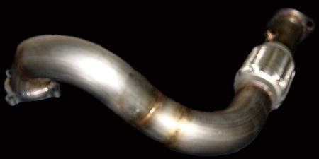

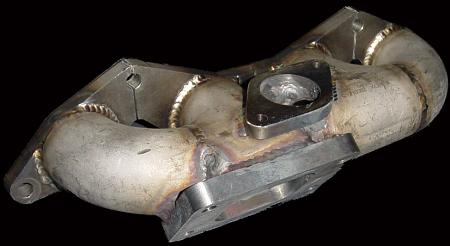

here is the manifold and downpipe....the manifold cost $399 and the downpipe is $379....i am propably going to get both of them until i can finish up my custom manifold...damn welder wont make time to finish it...it is started, but needs some more work....
i am pretty sure that maxrev might cut a deal if you order them both together...
http://www.maxrev.com/index2.html
