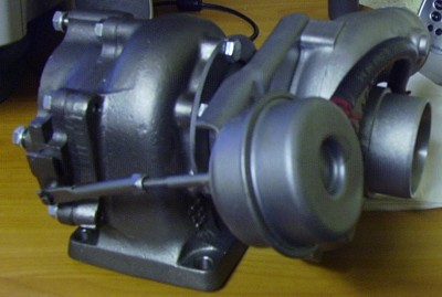

Here;s a pic of an "internally wastegated" turbo..... like it's been mentioned before, an external wastegate isn't really necessary if you're boostin 10psi or less. But you can do it.....it's not a no no or anything.

do you have a pic of an external wastegate turbo as for comparison?

External wastegate there. See the difference?
that's a supra btw.
