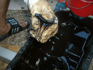

how bout throwing a rod.. without N0s...
NA!-
Old Mar 7, 2004
OsOBooSTeD's Avatar
OsOBaNNeD
Posts: 3,959
I/H/E ...

Originally posted by OsOBooSTeD
I/H/E ...
hahaha. I don't even know what to say to that, that hasn't already been said already.
